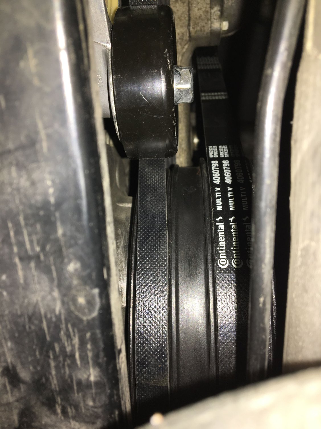

I'm going to go with the Summit Racing Harmonic balancer (race version). This will be my third and hopefully last one.
I just changed my belts and tensioner then noticed this.
