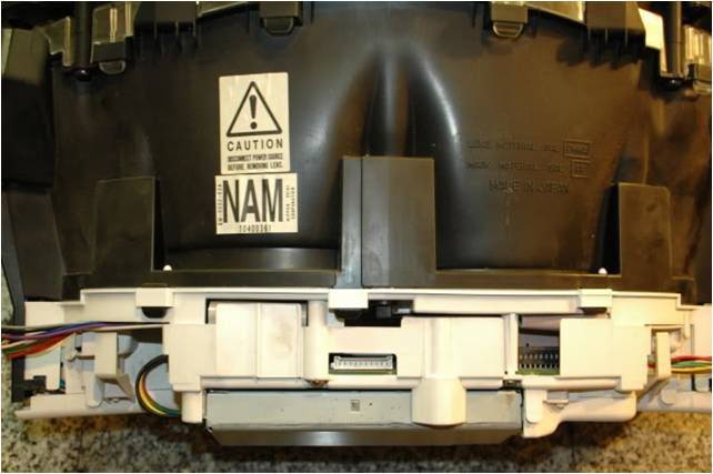

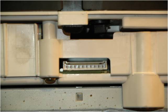

Originally Posted by 808_c5
Replaced my 98 cluster with two different newer years clusters, one C5 base and one Z06 cluster, and both worked. just not sure what years each were from. They we both non hud versions into my non hud car. Also had mileage reprogrammed cause i didnt want to have to keep track of it myself.
808_c5, just an FYI, if you changed to the Z06 cluster it is HUD capable. It may not have the switch on the left side to adjust it once the HUD is installed, but it does have the HUD harness connector plug-in. All later '99 through 2004 came with the connector plug-in. This just means you don't have to replace the entire cluster, just add the switch panel.
HUD Adjuster panel...
Good luck... GUSTO
