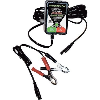

The maintainer that I have been using for almost 20 years now is called the BatteryMINDer Plus. I started using them originally because they also function to reduce sulfate deposits on the lead plates in a lead acid battery. This is more of a problem for normal wet cell batteries than AGM or Gel batteries, but I have continued to use them based on my experience with them.
Northern Tool is currently selling the latest version of the BatteryMINDer Plus on sale for $25. Less than a CTEK or a Deltran Battery Tender, but despite it's price I believe it's a good value and safe to use.
Full-time battery monitoring automatically tests battery continually, supplying only the current needed to maintain battery at full charge
The 8-stage unit charges and maintains from 1 to 4 batteries at a time (12V batteries parallel-connected or two 6V batteries series-connected. NOTE: Never connect 2 or more batteries together in parallel before fully charging each and checking their condition. Failure to fully charge each battery and check their condition can result in a serious safety hazard)
Regardless of which 'charger' you buy, I would insist on a 'maintainer' and not a 'trickle' charger. A maintainer maintains battery voltage by topping it off, then turning itself off until battery voltage drops to a preset voltage, when it turns itself back on. This is how it maintains battery voltage. A trickle charger does not work this way, it simply supplies power to a battery at a constant voltage. The maintainers will not recharge a dead battery, they're not intended to. Some will not even turn on if the battery is below a certain level or falls below a certain level. I believe that the CTEK and the Battery Tender's are both considered maintainers.

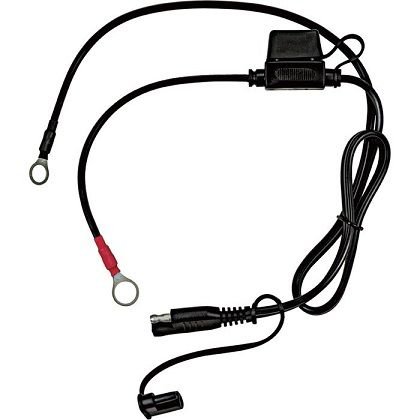

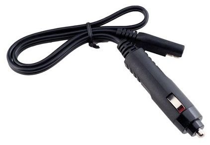

Most maintainers come with multiple ways of connection to the vehicle via plug in extensions. From alligator clips, to lighter adapters and even a pigtail that can be attached semi-permanently to the vehicles electrical system.

I use a ctek with the cigarette lighter plug in. Super easy to use and works great.

Whatever came with my C6 Z06 is also a Cigarette Lighter plug-in type. I went out-of-state for 53 days and zero issues upon return. Started right up.
