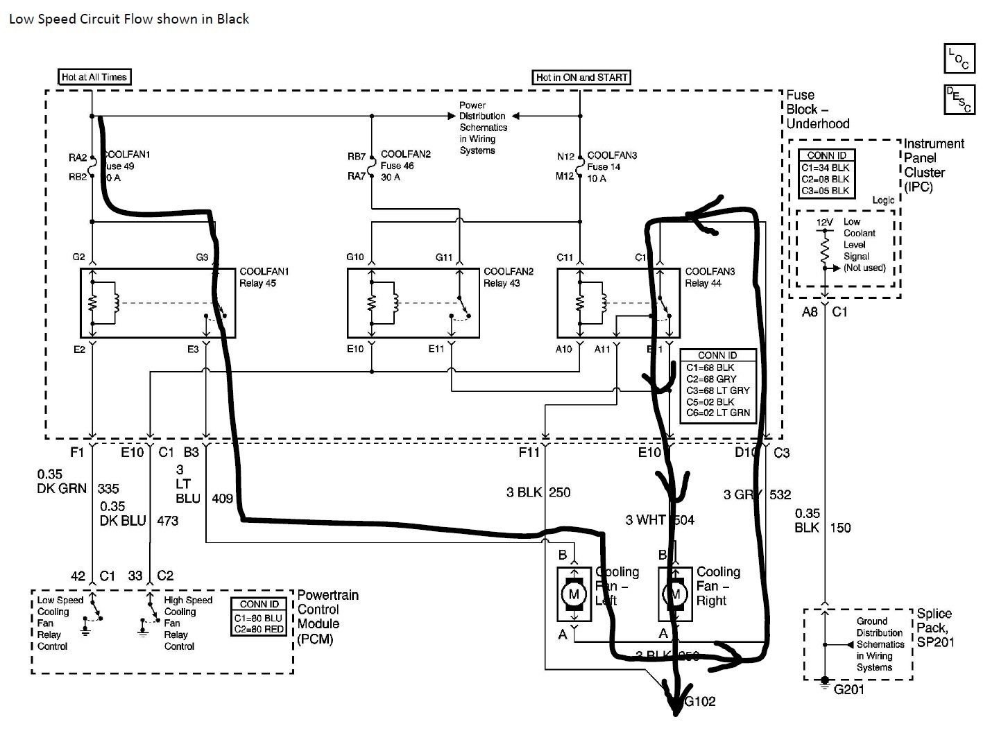

You need to provide more details: which fan, what happens in low and high modes, coolant temperature, what happens when a/c is turned on, etc.
In each speed setting both fans are supposed to run at the same time.
There are 2 fan circuits:
  • Low Speed (½ the speed) - fans configured in a Series Circuit where ½ the voltage is applied to each fan.
  • High Speed (full speed) - fans configured in a Parallel Circuit with full voltage to each fan.
These are the schematics with the current path superimposed for each speed setting to help you troubleshoot your problems.
Since the Low Speed mode is configured as a Series Circuit, any interruption along the current path should affect both fans.
On the other hand, in a Parallel Circuit it's possible to have none, both or either one.
I'm including here a description of how fans are commanded, so you can compare it to your car.
