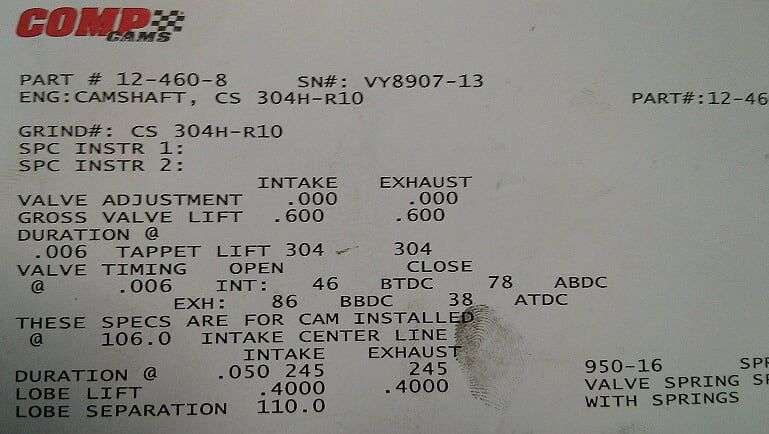

To give you some perspective, this cam was in my Trans am you see in the youtube video.
This was behind a garbage TH350 with 2.41 gear and a 3500RPM stall and stock 882 heads (the engine builder was a moron; this engine didn't make power at all). If the electric fan kicked in, the engine would stall and I would have to hold the throttle a little bit to keep it alive. I am totally fine dealing with this kind of compromise, especially if I get more powerband in the higher RPM and get meaner idle.
