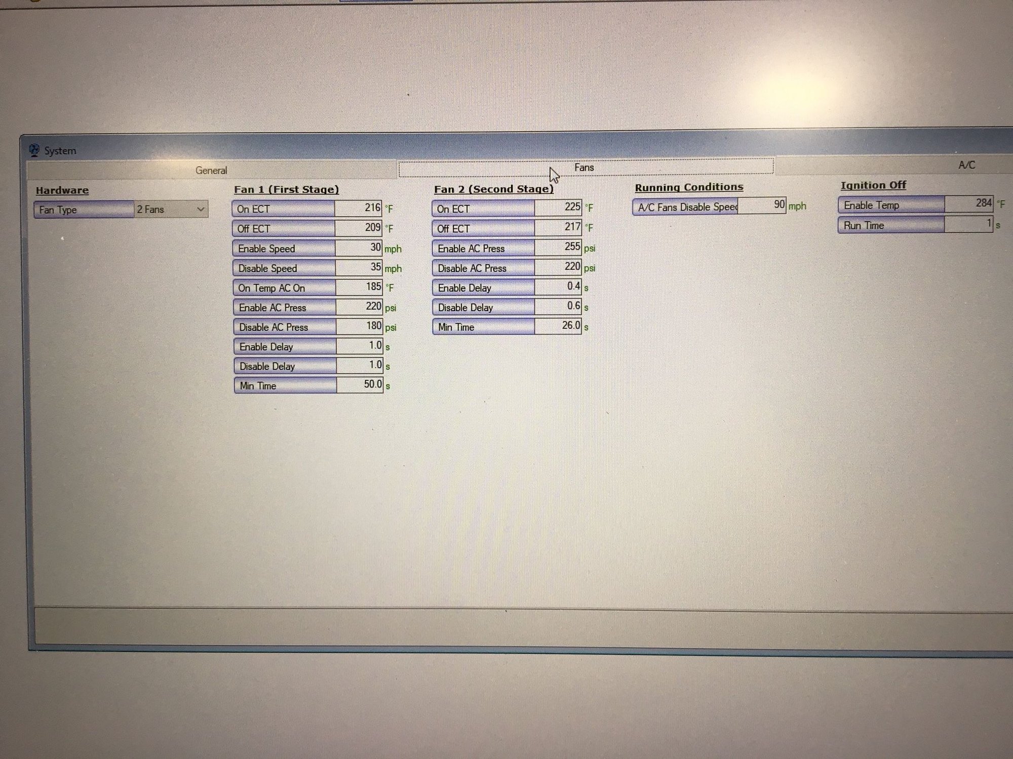

So I just got back from the shop and got him to turn off the VATS, adjust the fuel cut off to 256mph and lower the fan temps by 10 degrees across the board. I already have a CAGS kit and I know I coulda asked him to hit that button anyway but they were super busy and so I didn't wanna pester them.
I took a pic of the screen showing the new fan temps and noticed that for FAN #1, "Enable Speed" is set to 30mph and "Disable Speed" is set to 35mph.
I don't think he touched these.....but does this mean my low fan won't turn on at all until 30mph? Is that normal?
I believe if your coolant temp is 216 and your going -30mph it will stay on. And go off at 35 mph
...I took a pic of the screen showing the new fan temps and noticed that for FAN #1, "Enable Speed" is set to 30mph and "Disable Speed" is set to 35mph.
No, that's not what it means. The wording is not clear and labels are a bit misleading.
It says Fan1 and Fan2 as if in Low Speed mode only 1 fan is active and then the 2nd fan is added up in High Speed. Actually Fan1 means Low Speed (both fans together, but at half the speed) and Fan2 means High Speed (both fans together, at full speed).
The Disable Speed and Enable Speed means that fans will turn ON following the preset temperature thresholds, as long as you're below 35MPH (the Disable Speed). If you cross that threshold they will turn OFF regardless of temperature and will remain OFF as long as you're above 30MPH (the Enable Speed). As soon as you drop below 30MPH fans will revert to follow the preset temperature thresholds.
In other words, there is a 5MPH cushion much like the way thermostats work.

GCG makes everything clear
This behavior is also called hysteresis. It avoids the problem of you going precisely (eg) 35mph and the fans clicking on-off-on-off-on-off rapidly.
Same reason for the temperature on/off points being different. Avoids the problem of your water temps going to 225F and your fans clicking on-off-on-off constantly.
I only add this because precise terms make it way easier to google things for better understanding.
Got it...Thanks!!!
