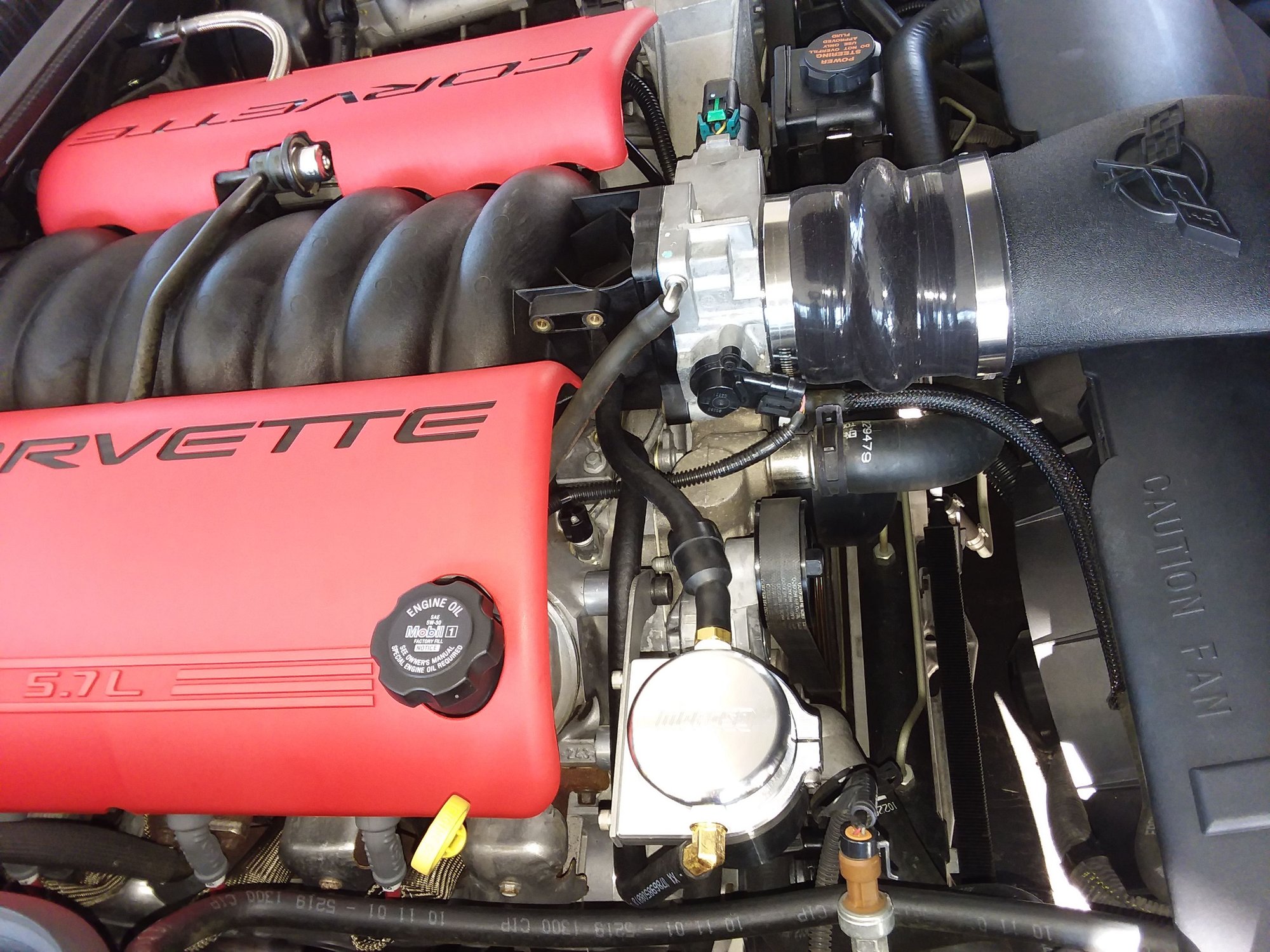

Here is the one I installed earlier this year. It's been doing it's job well and it's easy to drain.
https://www.corvetteforum.com/forums...n-85516-a.html
Steve
