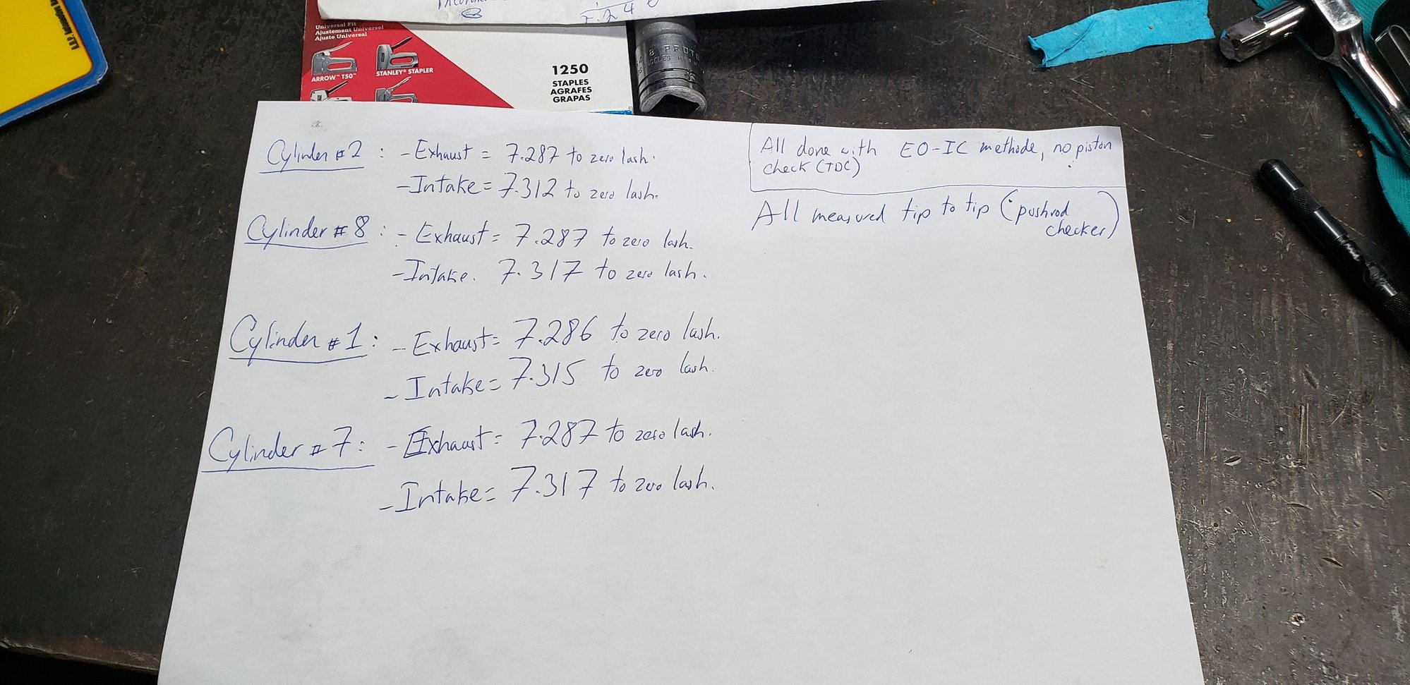

These are my results with the EOIC method with the pushrod checker measured tip to tip.
My cam has a 0.02 difference from intake base circle to exhaust base circle.
Something doesnt make sense... my previous measurements with stock lifters were very close to these... i should be much shorter from what i understand.

Is this maybe cause i lapped the valves?
Old Jul 27, 2019 | 02:42 PM
Georgies's Avatar
Georgies
Joined: Jan 2008
Posts: 1,235
Likes: 51
Or does lapping make for a shorter rod??
According to this with the .055 preload i want to run i averaged the size to 7.29. So that would make a total length of 7.345.
My old pushrods are 7.37. Should i get new rods or live with .08 preload?
