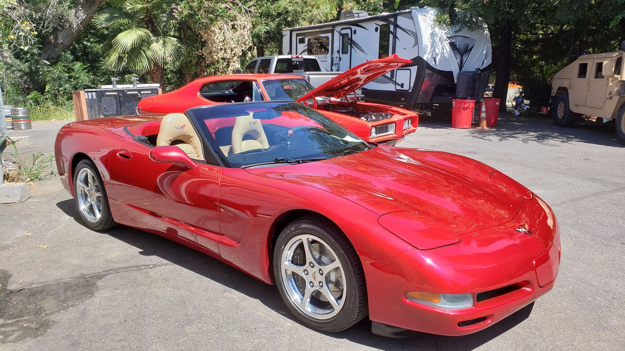

I am get some indication on my 2000. I am a novice so really don't know what hey mean. I can't get appointment with dealer for about a week. Can someone tell me what this means?. On dash I get "service ABS" and service "Active Handling". I do have a code reader and it indicates HCat and EGR (red circle and /) . Thanks

Thank you all. Iearming how to do it. Got about 6 U codes with H on end. Looking them up. Had 1 manual code but did not get it to come up. Will try again. It did clear up the active handling .got code b1255 ebtcm malfunction.

Took in to dealer, i need an electronic brake controller with active handling. Been on the computer for two hours no luck. Still looking.
