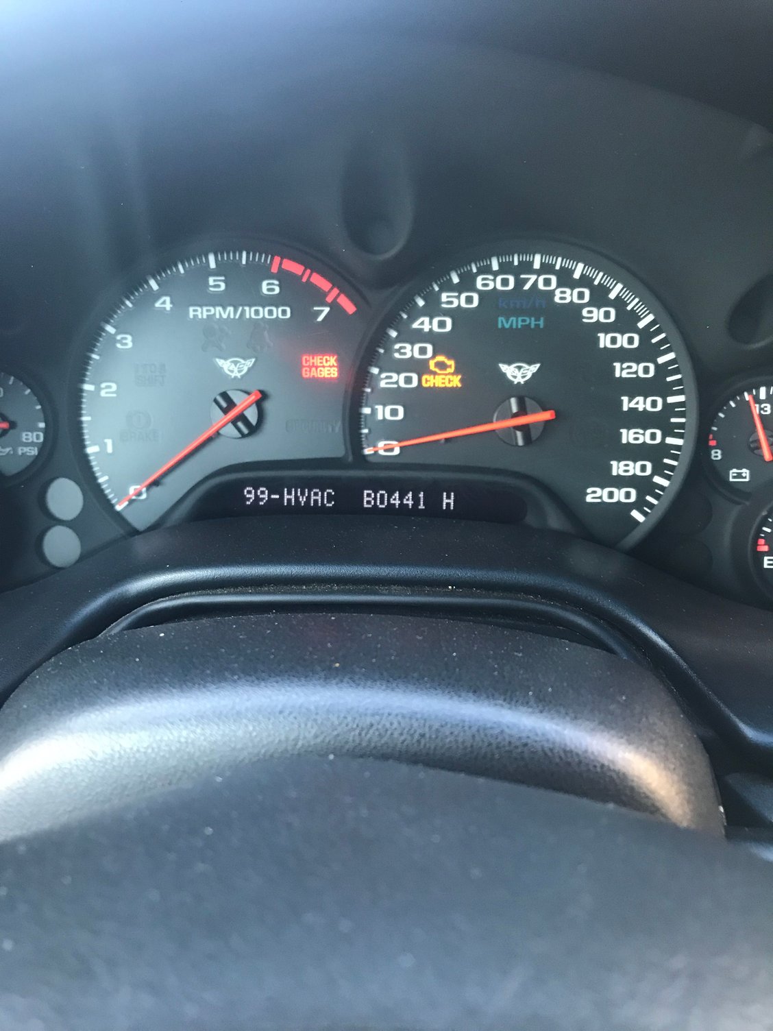

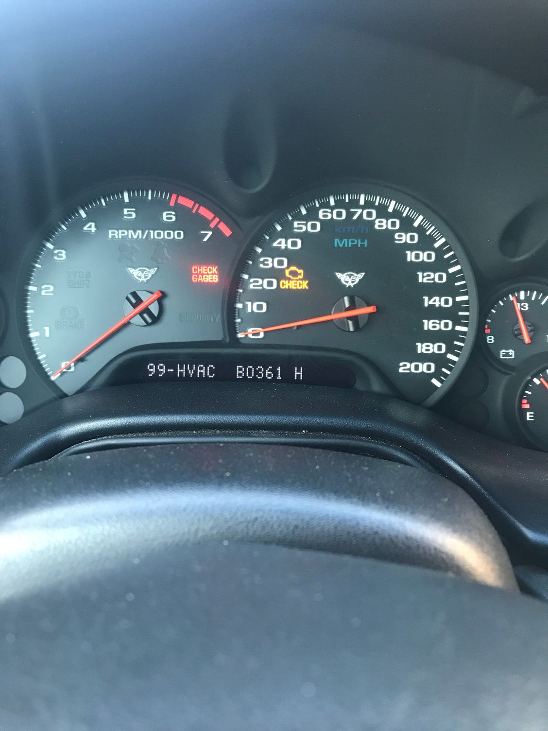

Do you have any codes on your DIC ?
Yeah 2 codes came up

The 2 codes showing are HVAC codes and have nothing to do with a no start issue. Can you hear the fuel pump come on when you first turn the key on? Your fuel pump may have died!
