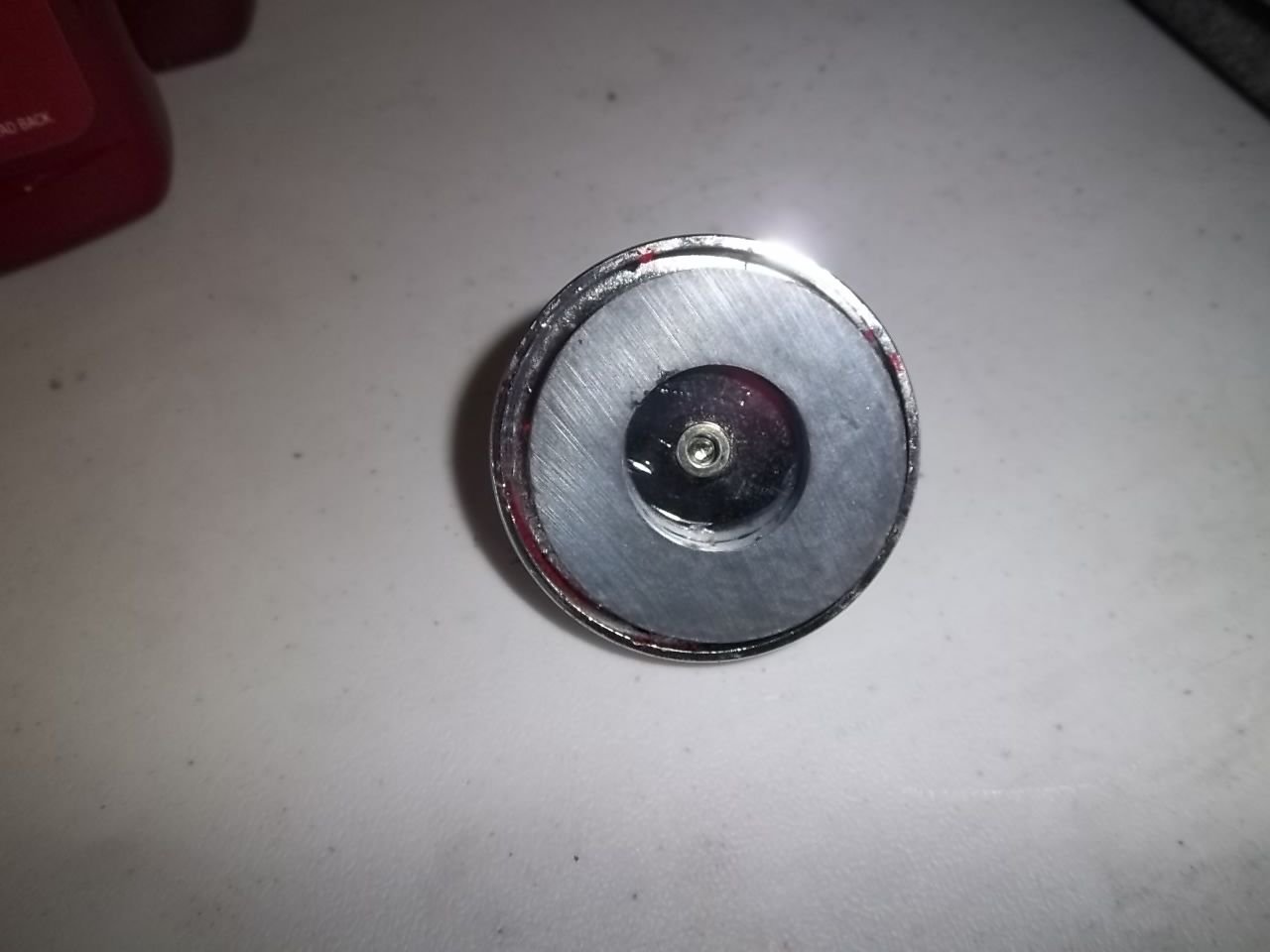

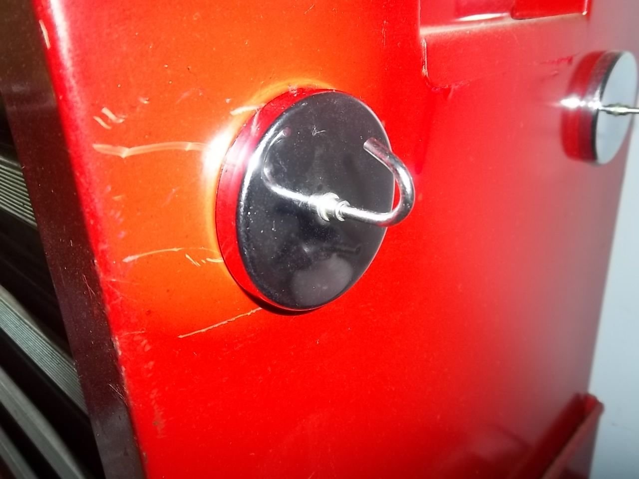

When I bought my magnet from Lowe's I bought a hook hanger that had a magnet that measured 1.75 in dia. and it was .25 thick with a .75 hole which allows it to fit over the valve stem. The magnet will pop out of the metal hangar housing very easily. This worked perfectly I had no problems at all, make sure you put it over the valve stem.
