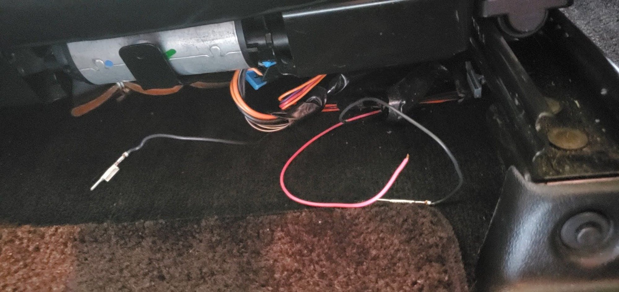

So from what I can tell, B2860 may explain why my telescoping steering isn't working, U1255 may have something to do with the 3 loose wires I found under my driver's seat this weekend, but all the rest I have no real idea on. Do any of these codes stand out as a possible cause of this? If not, should I be worried about any of these?

Originally Posted by STRMLNE
Whatever loose wires underneath the seat is likely also causing the telescopic steering wheel issue. If the seat wires are unplugged true telescopic wheel won’t work either.
whats the rpm when it starts jerking?
Yeah I saw that the telescoping steering is tied up in the seat controls under the driver's seat (for whatever reason, I'm not a designer so what do I know), so that's actually what had me looking under there this weekend hoping to just find a loose connection that I could jiggle and have it start working. Unfortunately I found 3 loose wires instead, so I'm gonna have to see if I can figure out what wires they are, where they came from, and if I can get them back together. I'll attach a pic, just incase anyone has any ideas about them.
