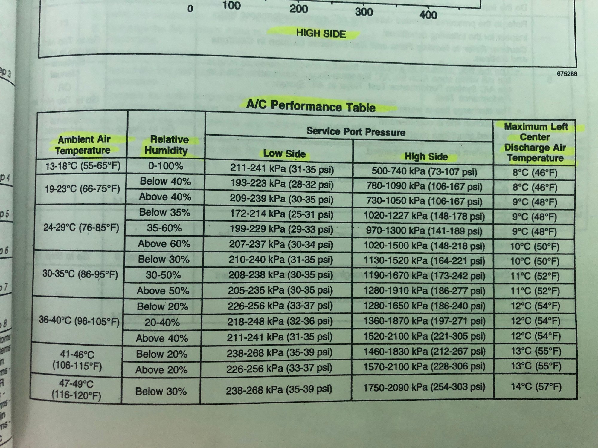

Phil, I got it and responded back...you really just need to hook up the low side initially after the car has been sitting for a bit engine off and everything equalizes...low side pressure should be fairly close to outside air temperature...30 is kind of borderline if engine running AC on...these are the pressures for my 2001 !!...and remember the bigger the spread between the high and low side pressures the better !!
