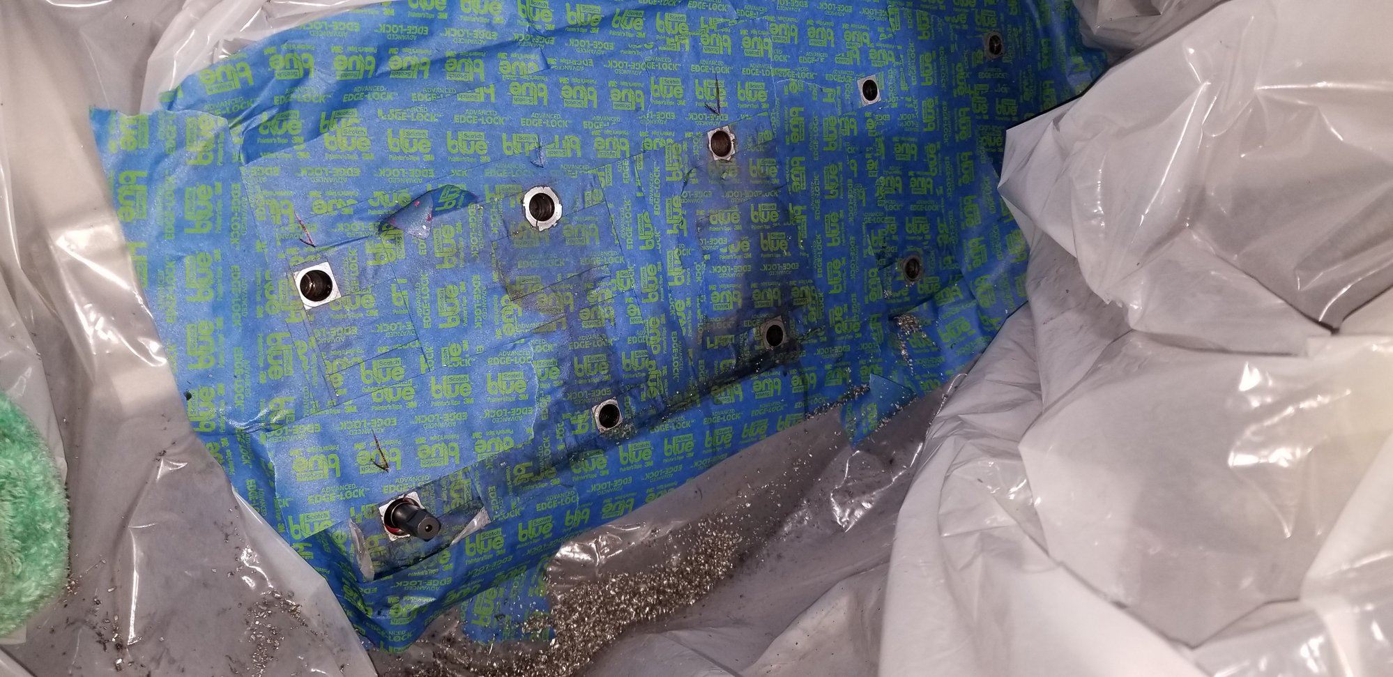

Welp taking off a head to swap to 317s in my stock ls1 and pulled the threads out with the bolt. I’ve researched this and it’s been posted before but no one has seemed to follow up on the success of the route they took.
Time sert makes a kit for the M11x2.0 to replace the threads but it is quite expensive for a one time use and no shops or dealerships want to touch it and I don’t blame them.
Also heard off drilling and inserting a helicoil with a bigger thread than the M11 but almost impossible to find a bolt to match length and TTY and head.
The next option is 1/2 head studs that I’m aware of.
If anyone has been through this and had success with one of these options or even another option, please let me know. Big pain in the butt and I was super cautious and careful with them and still ended up here.

https://ls1tech.com/forums/generatio...-timesert.html
https://ls1tech.com/forums/generatio...time-sert.html
Go with the Time Sert not a helicoil

Buy time sert, use what is needed and then sell it at a discount. Install arp studs and call it a day.

Time sert the damage hole and MAKE SURE that you get the real ARP head studs.
You will be fine after you get the bolt hole repaired. YES they sell Chineseium cheep head studs and YES they fail.

Also let me give you a word of advice. Once all holes are clean and the threads are chased. Run a stud/bolt into them one by one. If you cannot easily hand thread them into the hole, you will want to time sert it. I ended up doing all 20 holes in my block.
A 10 pack of time serts on Amazon is 40 dollars. I would advise buying 2 sets. Time Sert P/N 112030

They are honestly not that bad. You will find that actually drilling/cutting the new hole is better to do by hand (ratchet and a 3/8 square socket) . Trying to get a drill or anything in some spots can be cumbersome.

Just lemme know. The northstar kit will not work on a Gen 3 LS engine btw, so if that is all they have, do not use that kit.

Don't forget the make sure that EVERY bolt hole is spotless and DRY before you thread ANYTHING into it!
