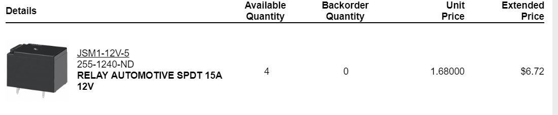

Thanks, for the reply doesn't look to difficult, I'm pretty good with electronics and assembly/disassembly, really just needed the SPDT PN more than anything else for the form factor.

I got mine from digikey
