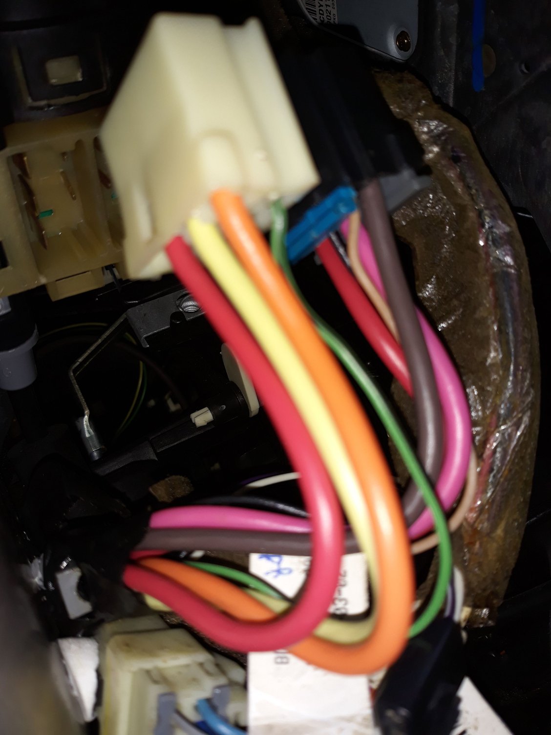

The wires just came out of the white female pins anyone know the correct order for them to put back in? The ones that go underneith the ignition switch. The bunch with the orange wire. etc

Are these wires in the correct order? Just the ones with the white pins, orange, yellow, red.

can someone give me the correct order for the white pin I have pictured, they all came out?

That's C1 it appears to be correct, I've uploaded the pinouts for you, see the attached image
