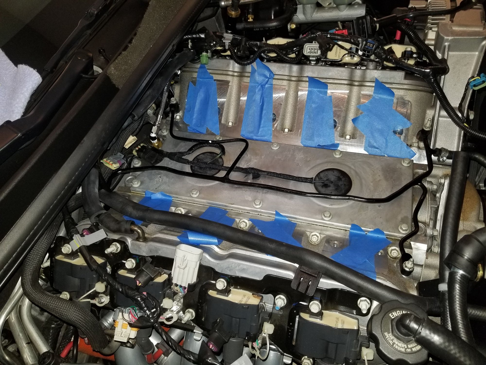

From my understanding it is due to the tilt of the engine and the way the coolant flows in from below the highest part of the engine instead of from the top like the old SBC did. I connected mine front and rear with single crossovers.
