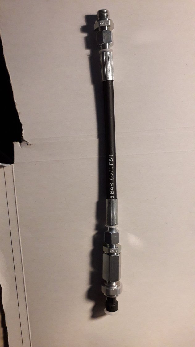

+10 , i have previous to replace my oil pressure sensor unit by removing the intake manifold
I go to an hydraulik professionnal to built an relocated system with 2 fitting :: M16 X 1.5 male at one extremity and M16X1.5 female at the over extremity
I put some pics when it was made
PS : Sorry for my bad writting
Fred

Hello ,
Here is my oil sender relocation , only made with M16 X 1.50 fitting
I will show you how i'll install it in the engine compartment
