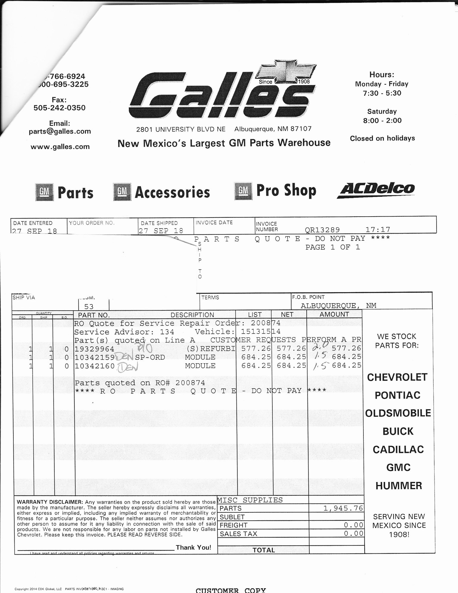

FWIW the service history for my new to me C5Z shows a quote for replacement of both door modules and the HVAC display at a cost of 2k + 5 hours. The old ones were in the trunk and both work so I assume it was done...
