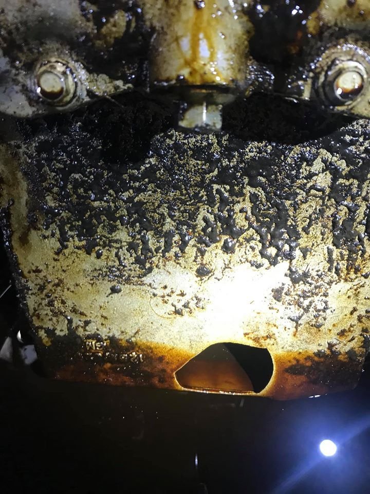

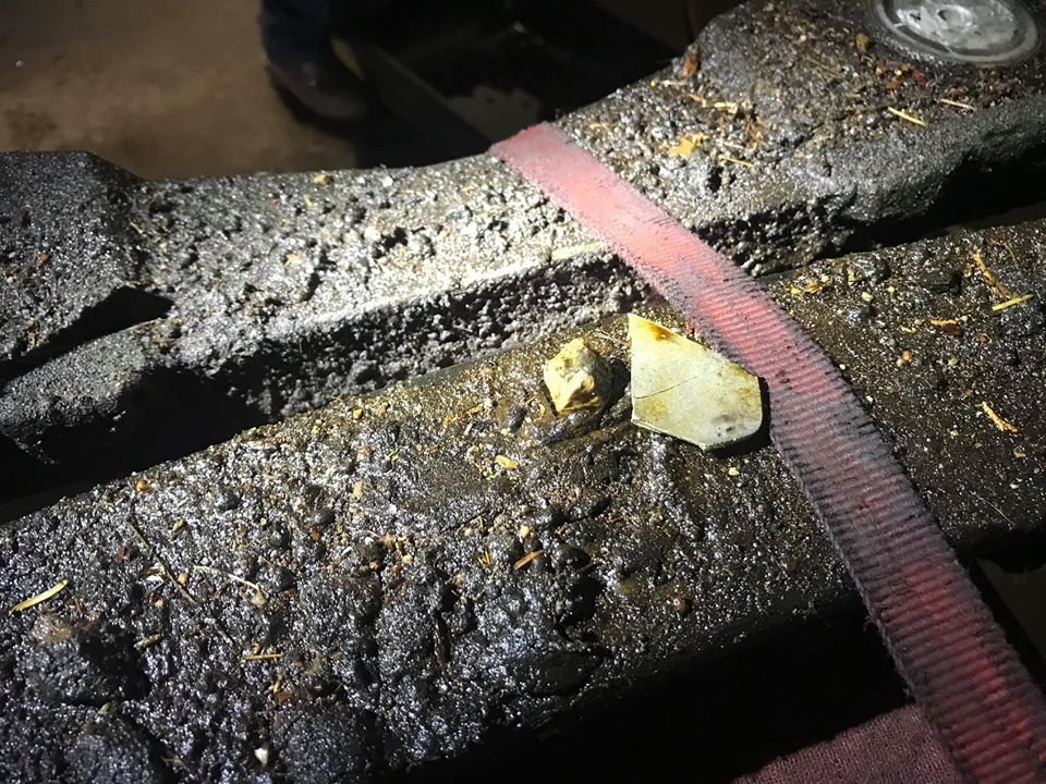

Thanks Bill ... so here's the update ... appears a rock was jammed up between the spring and the oil pan ... looks like it had been seeping some for some time. When I jacked up the car it was enough pressure to punch a hole in the oil pan. The techs did check the engine mounts and reported all was well.
So in the process of replacing the oil pan and of course cleaning things up. How in the world a rock could find its way up there is still a mystery but it is what it is ...
the rock and a chunk of oil pan !!!
now thats a Hole !!!
