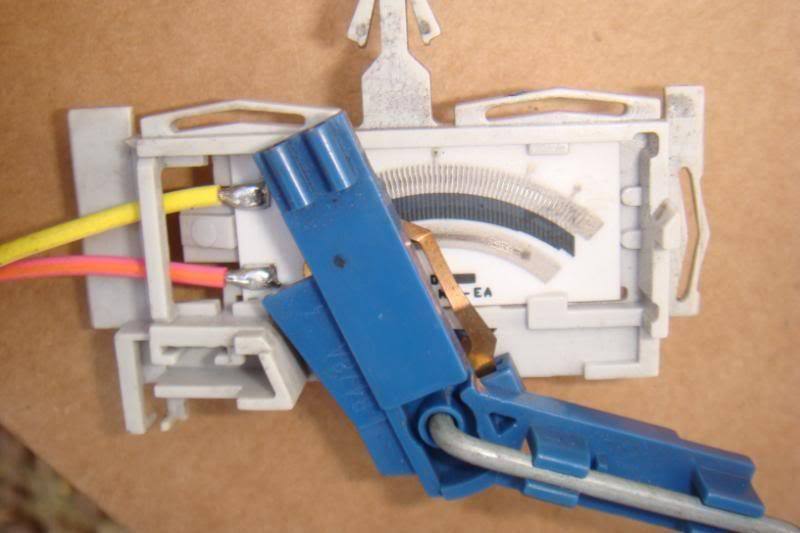

Originally Posted by Bills01vett
Driving home from work today and suddenly my gas gauge dropped from just above half tank to empty and a warning “check gauges” came on. I know I had plenty of gas. The only thing I did this tank is added Techron to my tank. When I got home I turned off my car and restarted it. The gauges all completed the function test, including the gas gauge, but then it dropped back to empty. Any thoughts?
sulfur deposits on the fuel card is most likely the problem...Techron dissolves the sulfur deposits...

Get the concentrated bottle of Techron instead of the cheaper version. Not many people on this forum are aware that Marvel Mystery Oil is also a good cleaner, lubricant and works even better than Techron removing sulfur deposits. I switch between the two to get the best benefits of both.
