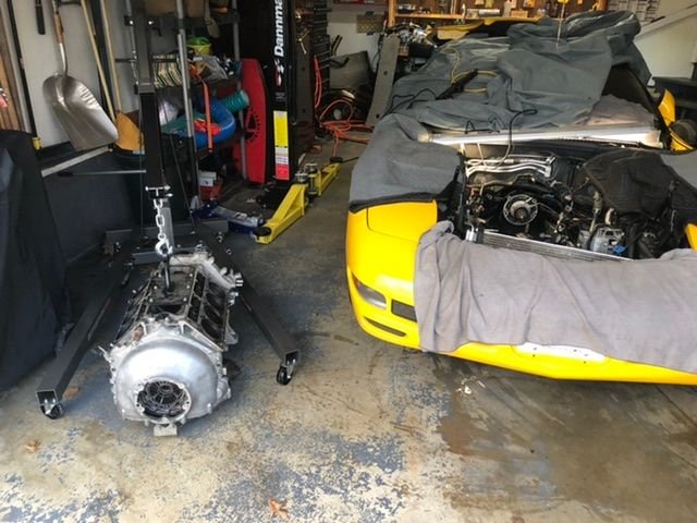

It was a lot of damn work but I got the motor out. For those that said they pull the motor from the top without dropping the subframe do something special. I don't know how it's possible. I had to drop the subframe about 10 inches to get enough clearance. I'm not looking forward to putting the motor back in and lining up the input shaft to the motor.

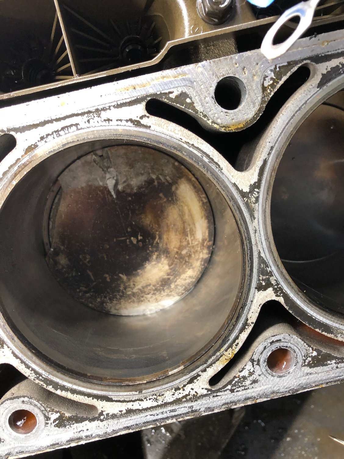

As you can see lost a piston. I drained the oil and there was no metal in the oil. I'm waiting to hear from the machine shop on when they want me to drop the motor off.

Originally Posted by KT35
it’s a weekend car so I won’t be driving at all. Another guy said it could be a bent pushrods.
Pushrods wouldn't have given you a coolant leak.
Well found the problem.
at the bottom of the image we are looking at the top lip of the bore. Is there an illusion being created by a piece of gasket that is no longer lined up or what am I looking at there?
yes I can see your piston is broken and some additional damage took place when the broken piece clobbered the top of the Piston again at around 12 oclock in the photo.

the tiny specs on that piston look like detonation, that's probably what caused the cracked ring land... might not be a bad idea to have your injectors cleaned and check out the rest of your fuel system when things go back together... if that all checks out consider another tuner... how much power was the car making and are you using meth or e85?
Yea its just an illusion in the pic, just a piece of old gasket.
I think the specs are part off the piston that broke up and got smashed on the piston. None of the other pistons have any signs. I was making 595rwhp no meth or E85.

not the chunks, the little tiny specs that look like pepper... that's what detonation looks like and will kill a stock motor fast... I'd guess that you either have an injector that wasn't spraying properly, bad gas, the tune was a little too aggressive, or a mixture of those things... it should have lasted a long time at that power level assuming everything was done correctly... you might look into adding a meth kit for a little extra insurance

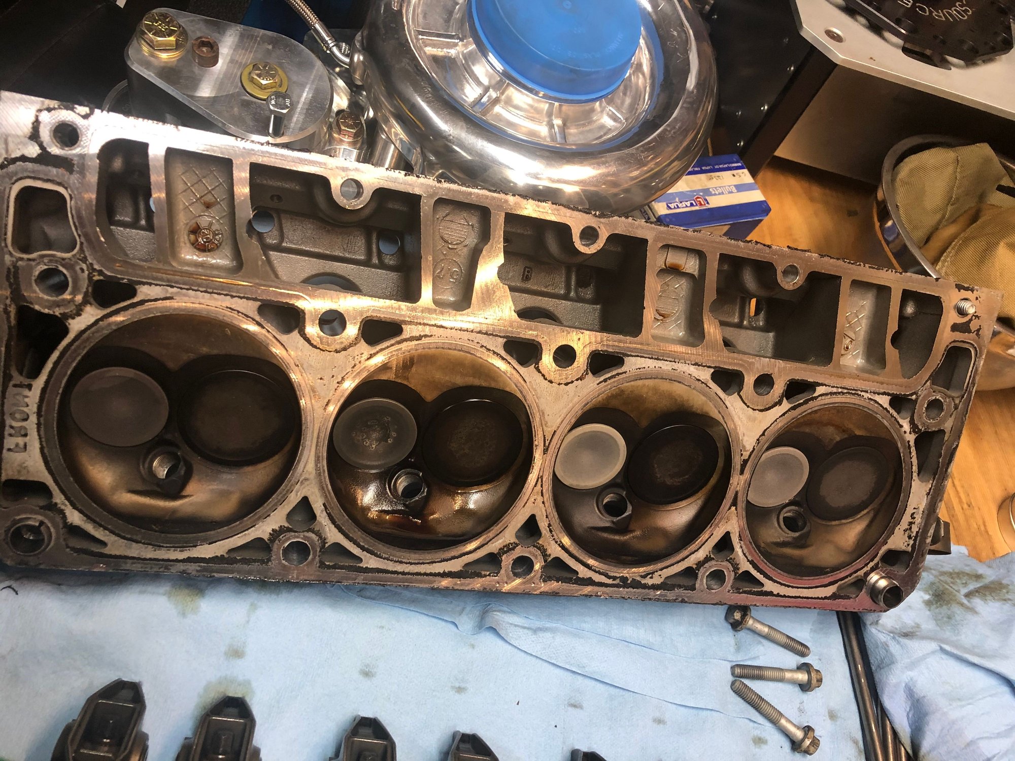

Top picture left to right 3rd valve in looks mushroomed. Some sort of lean conditions! Spark plugs could have been to tight also. Only hand tight with a quarter if that just snug! I would also flash back the stock file and get another reputable tuner to take over and re tune totally in SD !
