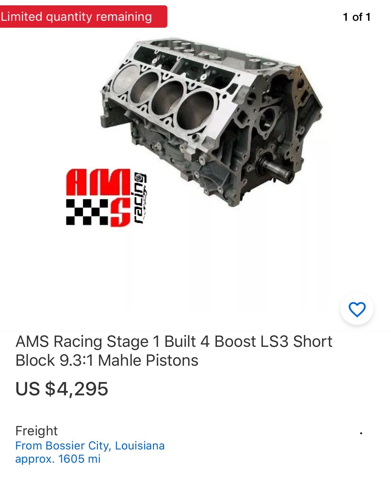

Originally Posted by Speedy007
This literally took me 5 seconds to find I’m sure with a in depth search you could save more ! Or haggle if your negotiation skills are at par !
Speedy thanks man! I never heard of that company before. I was looking at TSP and Thompson and there prices were a lot higher.
with the LS3 block I need to change intake, injectors and TB due to having to use LS3 heads correct?
All your upper half will work fine ! Swap it over ! Make sure crank is a 24x reluctor or you will need the adapter stuff to convert 58x to 24x signal ! When my day comes I will run my cathedral ports and intake ect on a ls3 block similar to what I posted up top.High performance coils ect should be added to your ignition and a property gapped tr6 plug as the box was labeled maybe even a tad less. .30. Some minor extensions for the crank sensor or oil sensor might need to be added but it’s nothing major that’s gonna cost a fortune. At this time you could also choose a dry sump with oil squirters and go all out lol. It would be a replica sorta ls9 then! Big & beefy yeahhh buddy how about that 900 hp getter wooo hooo!
Throttle body change it or not change it. A velocity stack port wouldn’t hurt lol there’s a place in So Cal I read about does this unique port! It all depends man how much power and fast you want to go. My goal is 1k to 1500 on a aluminum built block! Although I just want the power to have if I need it
