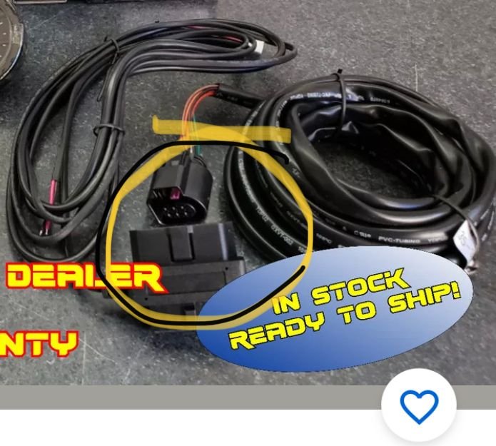

Aem has connection adapter to sync the mpvi2 while in operation it’s simple plug it in the obd2
Do I need to buy the pro series to make this work or just the regular MPVI2?
Looks like you can use regular to log but you can't make your own changes to the tune. Your going to regret (IMO) not getting the tunable upgrade if you continue to keep modding. Taking it back to the tuner gets expensive. Ask how i know. But that's just me.
The way i look at it is, what's the point logging and see the tune needs to be adjusted and don't have the ability to do it .but make appointments and then pay.
It's overwhelming at first, but once you get to know what parameters to adjust it's not bad. I was tested with an IQ of 57 and i can do it.
pro cable allows you actually live log your afr it’s another expensive add on 250 ish I think. That’s just for the upgraded software through hpt and the actual cable what I pictured above everything was in the the box , gauge ,wide band , hook ups / piggie back so you can run your hpt also it’s like you plug the piggie back in so your afr gauge can log and has enough power then your hpt fits on that all on the obd2 port ! What that guy said is right if you don’t get the needed parts now to log and tune later then it’s a waste of time and money! I thought and planned and read more before buying most of the stuff I have a long list pay pal and affirm love me lol !
I stock pile my parts then replace and re tune FYI!
