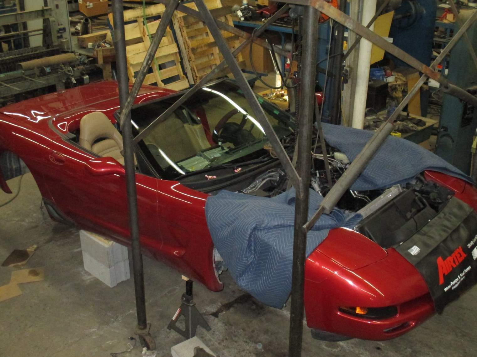

when I did mine I took everything out the bottom. I did my car at work where I have a shop crane for over top of the lathes. It's on Wheels so I was able to maneuver it over top of the car. It's largely similar to the ones available at Harbor Freight and if I didn't have it I would own one of those in a heartbeat. I was able to use a lifting strap down to a point on each side of the frame I'm simply lift the car while it pivoted on blocks that were underneath the rear jacking points. It works slick as could be. I had an electric hoist hanging from the trolley on the crane and could control it from underneath the car if I wanted to. They were of course jack stands and other things for safety.
I've done two out the bottom so far and I see people talk about them coming out the top but I really don't think I would even try it. Fact is I think you could lift the front of the car enough with a cherry picker to get the engine and cradle out from underneath. When I did my C5 I had the entire Driveline from engine to rear with both cradles assembled before I connected it. Only way to go in my opinion. I had the whole thing on one of those heavy duty Harbor Freight furniture movers and the engine was on a pallet jack. If I can find some pictures I'll post them here.

Here's a couple pics of when I did my C5. Sorry for the cell phone quality...
Harbor Freight has a crane that looks really nice, and would do this with ease. They have these at the store near here and I have to say, it looks solid.
https://www.harborfreight.com/1-ton-...ane-41188.html
And my pics:
Just ignore the pallet-racking laying on top of the crane. It's been used since.

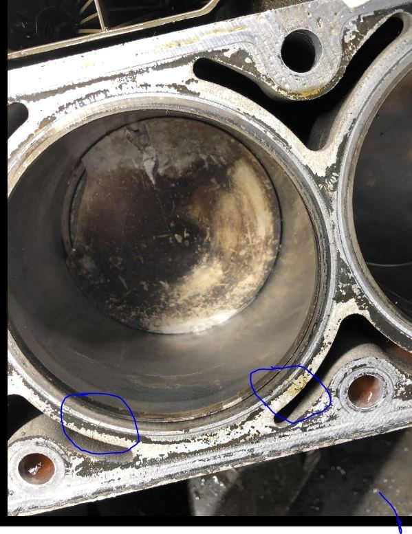

I am concerned by this. May just be the picture but....

Likes: 102
The shop cleaned the block and pressure tested the block. I will have them check these areas though. Good catch.

As you can see the cylinder top have cracked why risk it at that point how long until it disintegrated?
Speedy,
I don't know that it is cracked. The builder said the block looked good and was not cracked. I will have the builder look at the cracks in the picture but I don't think they are cracks. I looked at the picture in detail and they look like the cracks are just on the head gasket material.
If the block is cracked I will not use. However an LSX block is not in the picture as they run about 3700 just for the block.
KT
