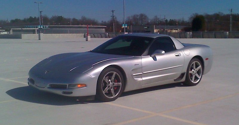

285 square on stock c5z 17's, some tramlining

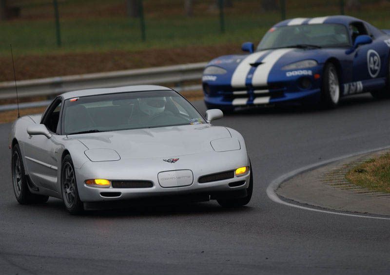

Minimal tramlining with this setup
03 C5Z 275 245 PS2's Nicely balanced
