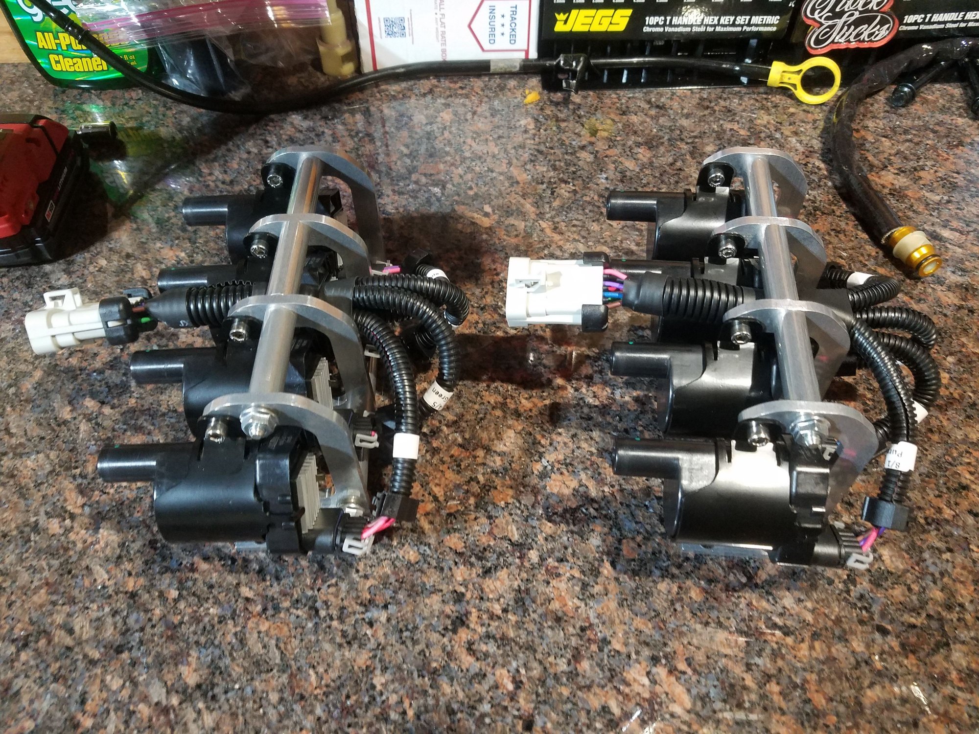

What are some of the top quality wires to be had out there right now?
I'm not looking for oem kits. I am once again remote mounting my coils, having just assembled the frame to secure the new D585 truck coils.
I have my old notes somewhere on my computer regarding lengths, boot types and angles needed from my first attempt.
But what is a top wire set for a high performance build?
First time through I did it all myself with trips to sears and Napa. Lol. This time I went easy with an ICT frame kit and Michigan motorsports wire looms. I feel like I am cheating!!

Taylor and Accel make universal kits that have ceramic ends that protect the boots from heat and you don't have to use those crappy socks
who makes those coil brackets?... I have the same coils but those brackets look nicer than the ones I have
