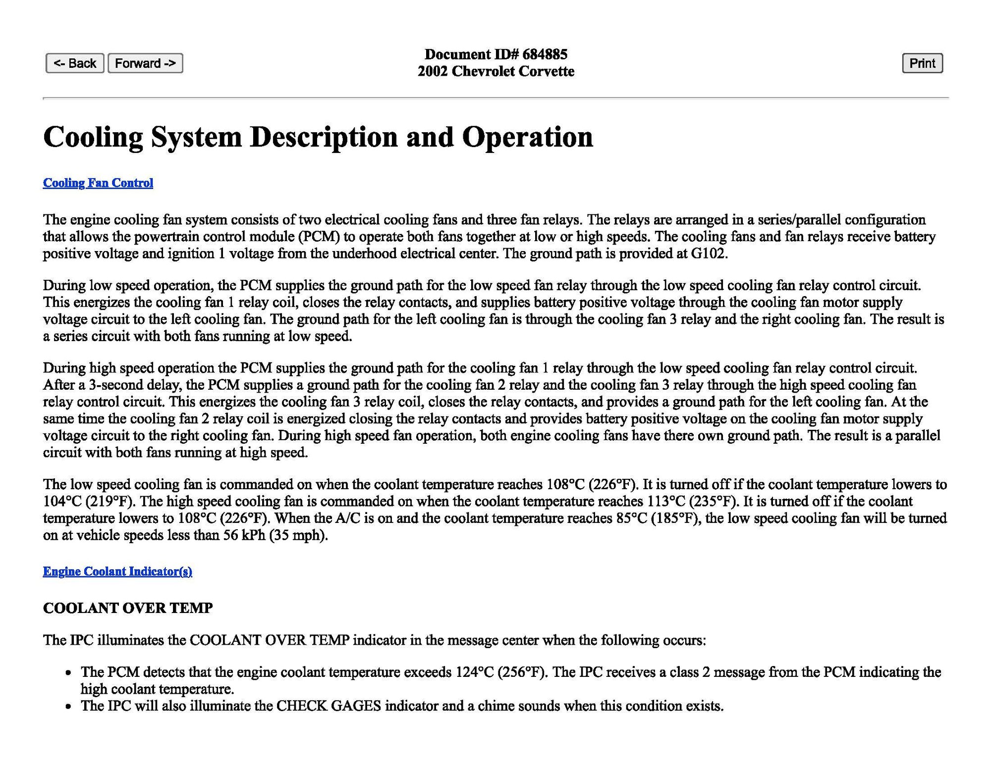

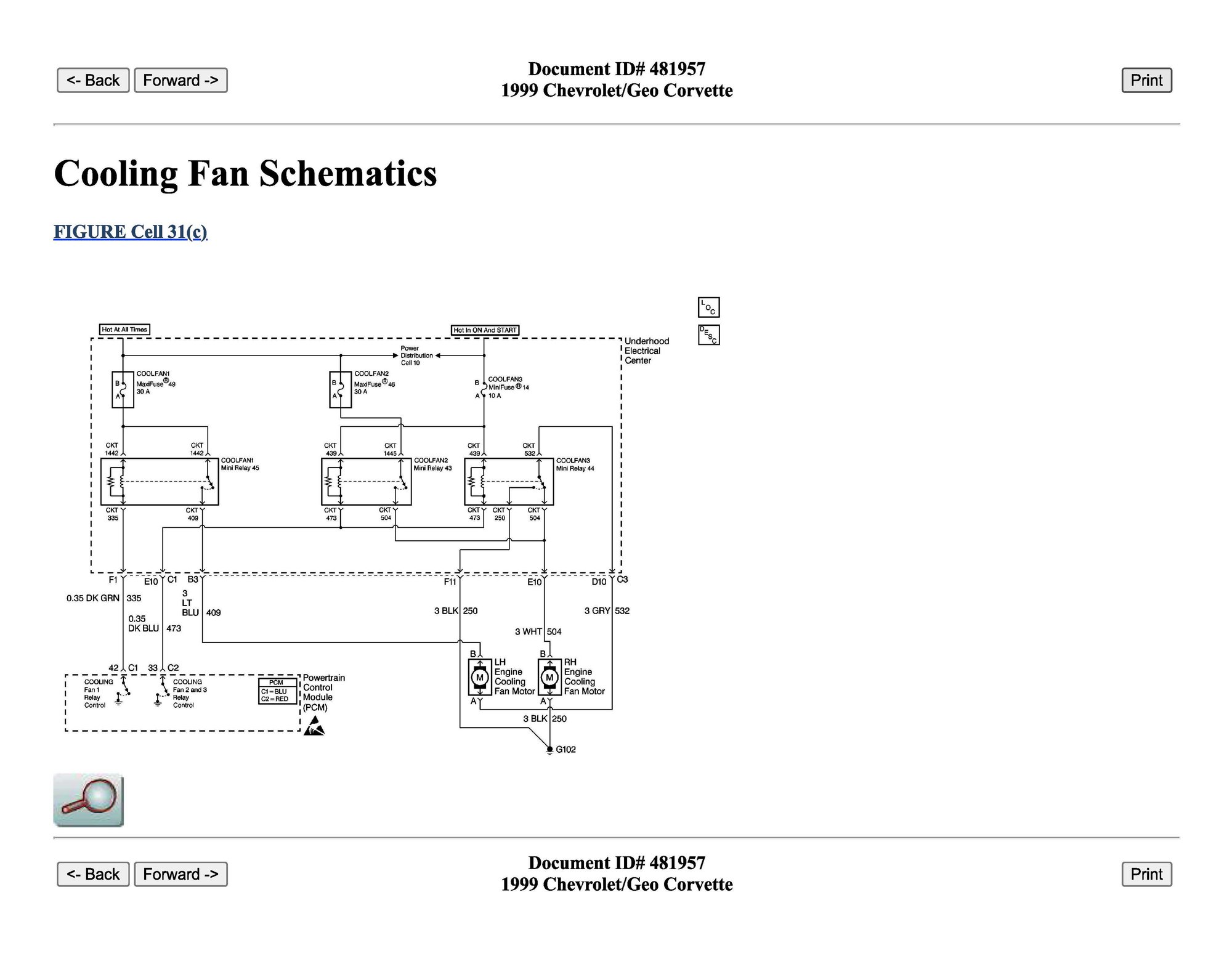

There are no solenoids in the cooling fan circuit. There are 3 "relays".

Hey Lucky, which of those relays takes the fans to high speed?
In your car what coolant temps do you see on a 95 degree day, in stop and go traffic with the AC on?
