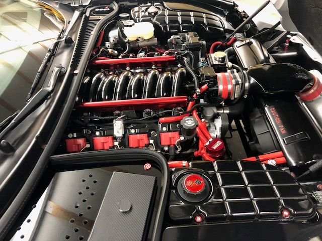

this is fairly easy the line from the valley cover with the pcv valve goes to the intake rear of TB, the right valve cover line goes to the TB, plug the drivers side valve cover.
I have a catch can so the pic is the best I can provide !!!

Ok, I think I got a grasp on all this stuff, lol. I see the red line from the passenger valve cover to the TB. And theres a red line from your valley cover to the catch can, and then catch can to intake?
As for the steam vents, I think I figured that out... basically the kit ties together all four vents in the cylinder heads and then routes to the radiator. Is your steam line the red one on the radiator, just next to where the black radiator hose connects on the drivers side of the radiator?
