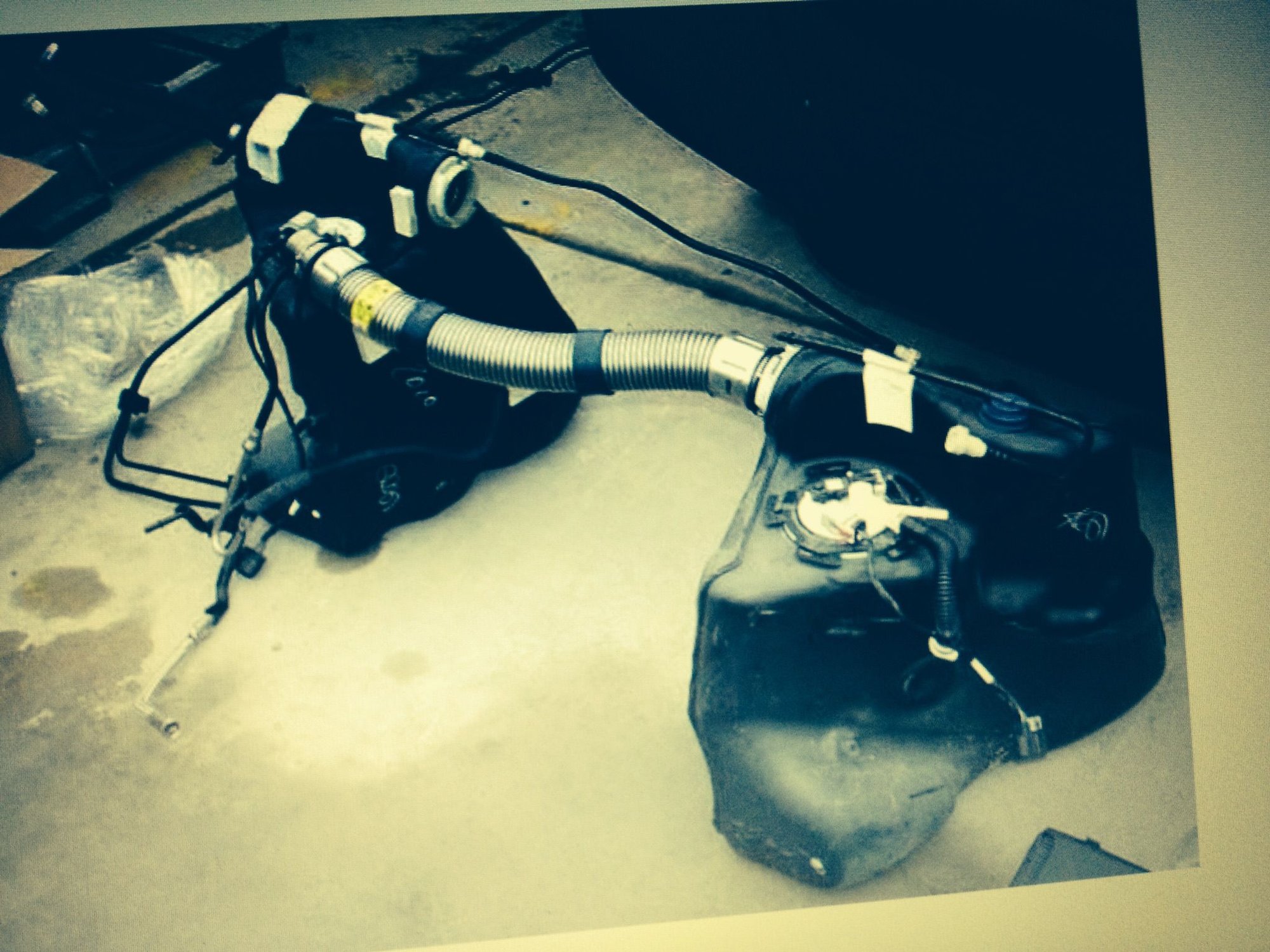

OP, If your referring to the gas leak from Cross Over leak my 04 had the "Cross Over" repair done and here are some pictures. Picture with finger pointing to white plastic part is the part that was bad. They were able to remove fuel system by removing driver side rear tire and plastic wheel liner.

I purchased complete tanks and crossover pipe from Vettepros. I think this is the best way to go. These tanks are outside the VIN numbers from the service bulletin. Now I have to find someone I can trust to install them. I'd do it myself but I'm old and disabled. I live near Ocala, Florida and a good honest mechanic is sometimes hard to find. Loved the pictures. Thanks.
