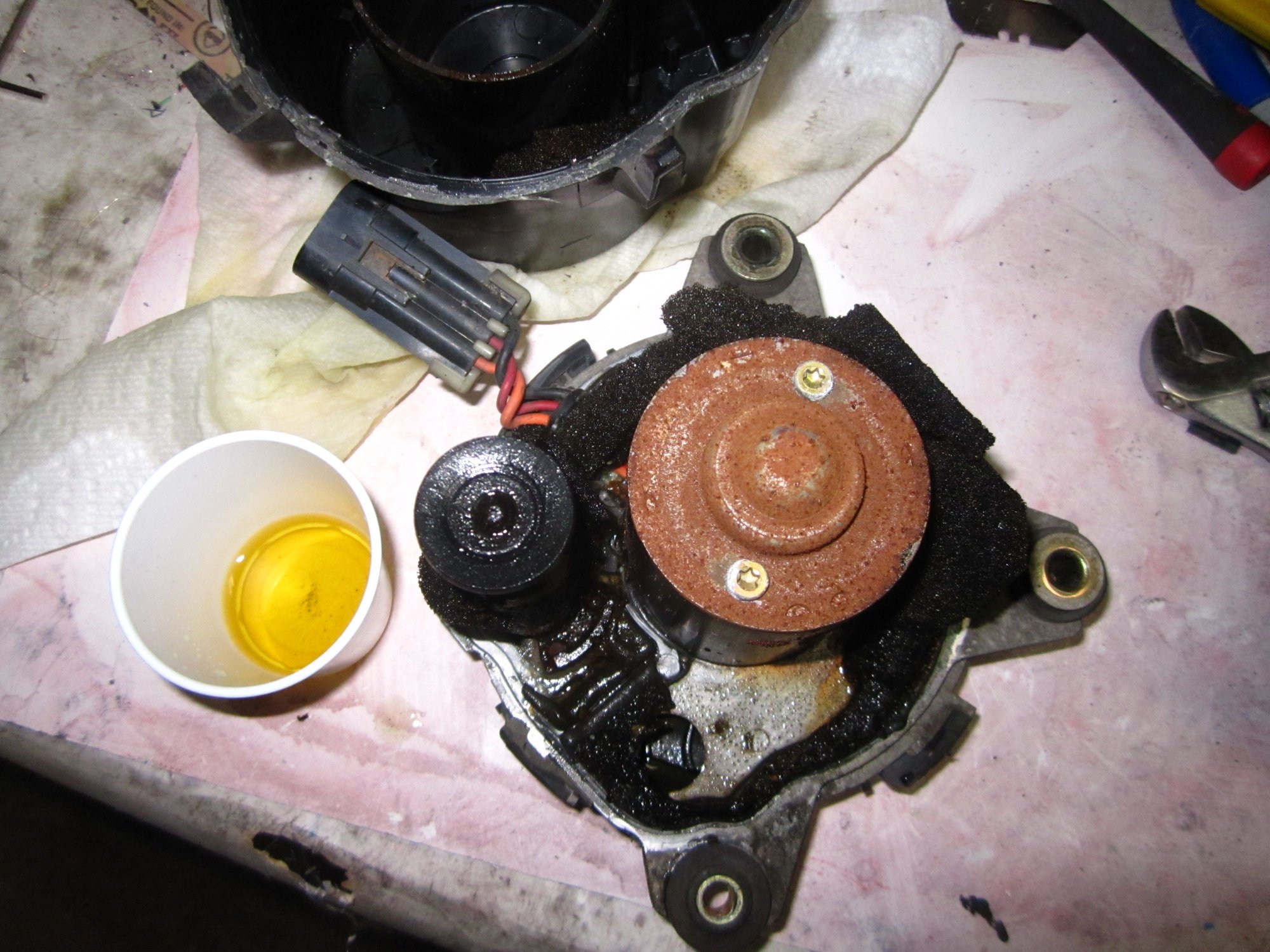

I removed the pump from my 125,0000 mile '98 because the check engine light was on for it, it was filled with yellow water as seen in the photo. All the foam inside was shot, the motor was seized and the solenoild valve was rusted closed. If the AIR codes are permanently deleted and the pump eliminated can the small tube on the exhaust manifolds also be eliminated along with the check valves and the manifold ports capped? All the inspectors around here care about is if the check engine light is on or not, they don't look for missing AIR parts.
