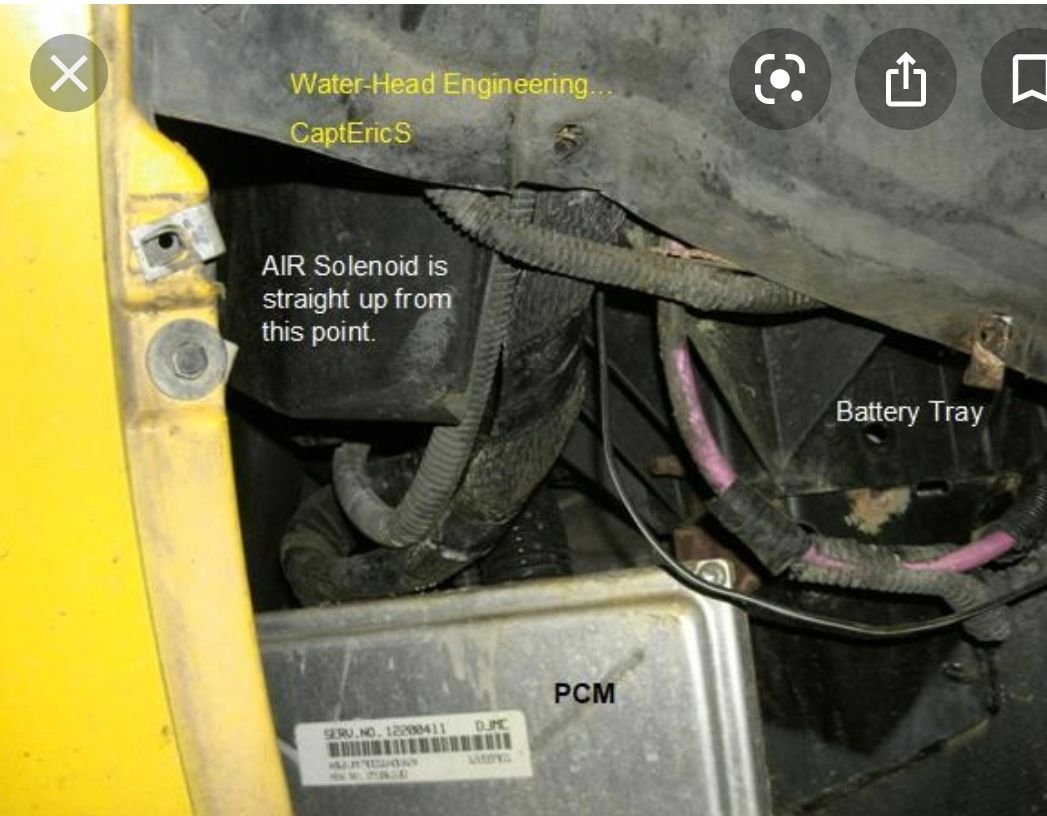

im still having trouble finding the solenoid for the air pump system.
Above the PCM !!
