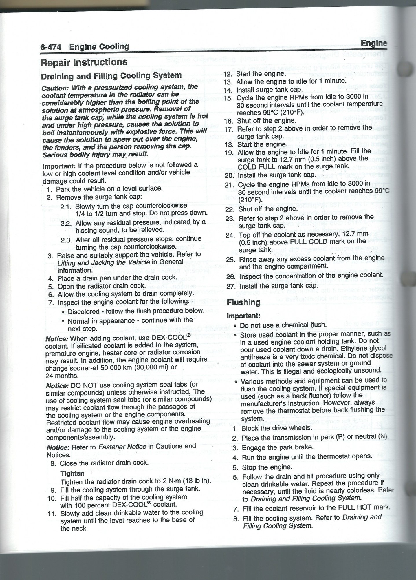

I assume that when you say "done the coolant procedure" you mean that you did the FSM procedure for removing air in the heads, If not, post back.

The most common scenario I see is that a C5 owner opens the cooling system for some reason, like you changing the water pump, and then coolant temperatures are higher than before, sometimes much higher.
Often but not always, higher coolant temperatures after opening the cooling system are because all the air was not removed from the heads. The Factory Service Manual has a procedure for that is designed to get the air out. Note the part about cycling up to 3,000 RPM and back down.
There are other things that can be done if the FSM procedure does not work. Try it first and then post your results.

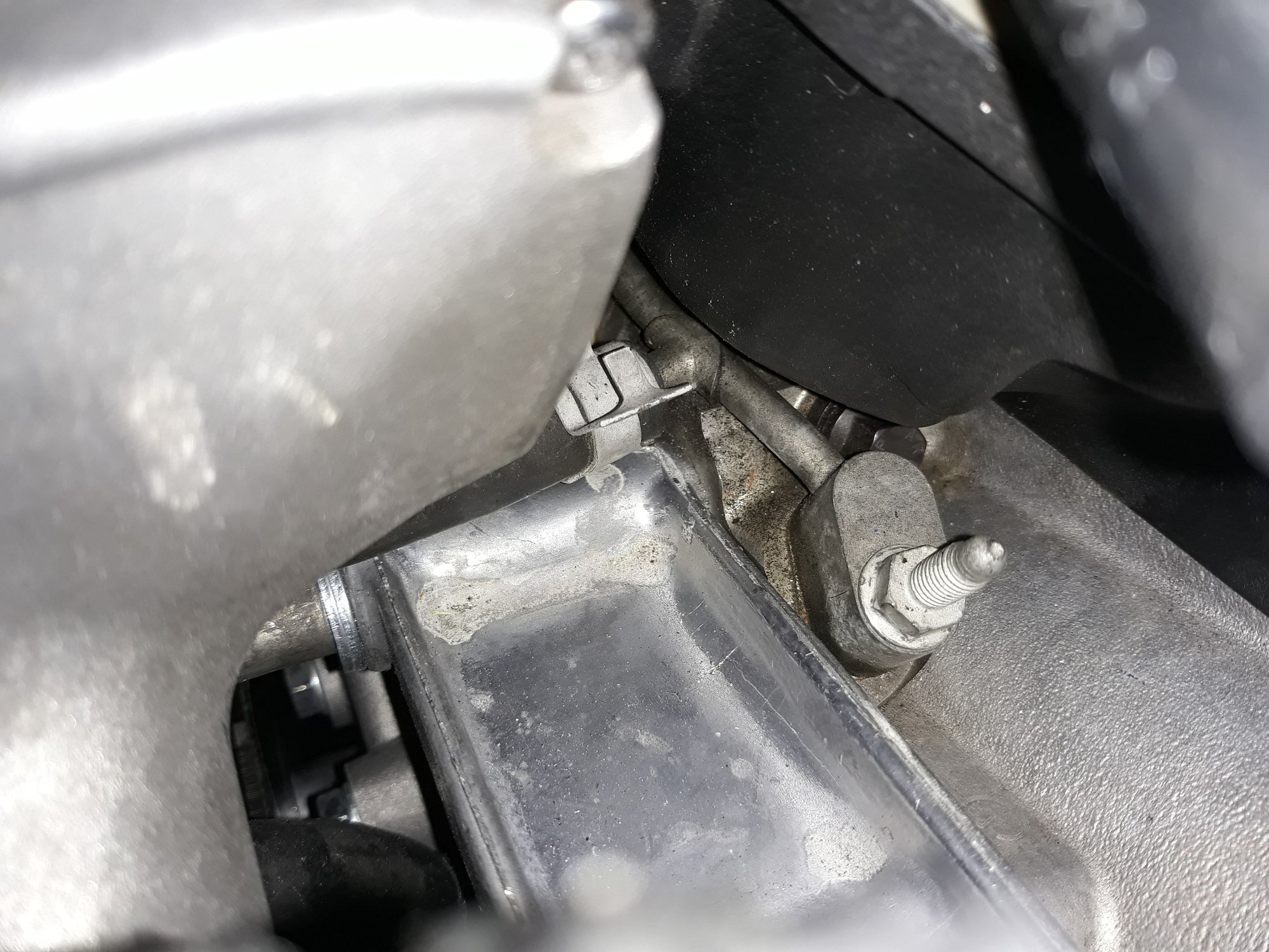

UPdate, I researched this topic and found out that sometimes the GM procedure does not work or may take a few times to get the air out.
There is a cross bar between the cylinder heads, I just loosed the passenger side and guess what air hissed out, a good amount to. I did it for both passenger and driver side, when the coolant comes out just tighten the bolt back up.
I test drove the car and the temps came down about 5 degrees, When I parked the car I unloosed the bolts again and more air came out. Some forum members had success doing this. I take a picture of it.
Air gets trapped in the cylinder head passages, this relieves it.

Loosen this bolt from the driver side and passenger side until some coolant comes out then tighten.
