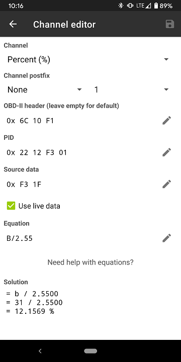

Did a little more nerding out to figure out the actual PID info for the ethanol stuff, so you could view ethanol content, ethanol sensor frequency and fuel temp in Torque phone app or similar.
Set OBD header to "Auto" or "6C 10 F1"
Name--------------------------PID--------Equation-----------------Units
Ethanol Sensor Frequency---22139C----A-------------------------Hz
Ethanol Content--------------2212F3----A/2.55-------------------%
Fuel Temp--------------------22139D----A-40 (I think)------------*C

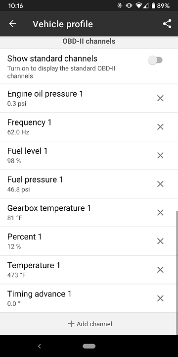

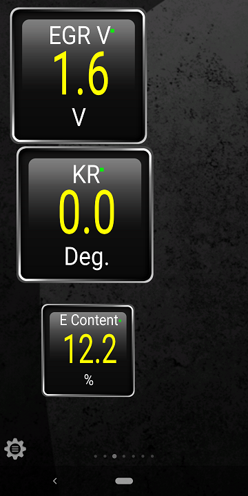

Well it's really not much to look at, but here is ethanol content showing in Torque Pro and Racechrono app on my phone.

12% lol run 80% .
