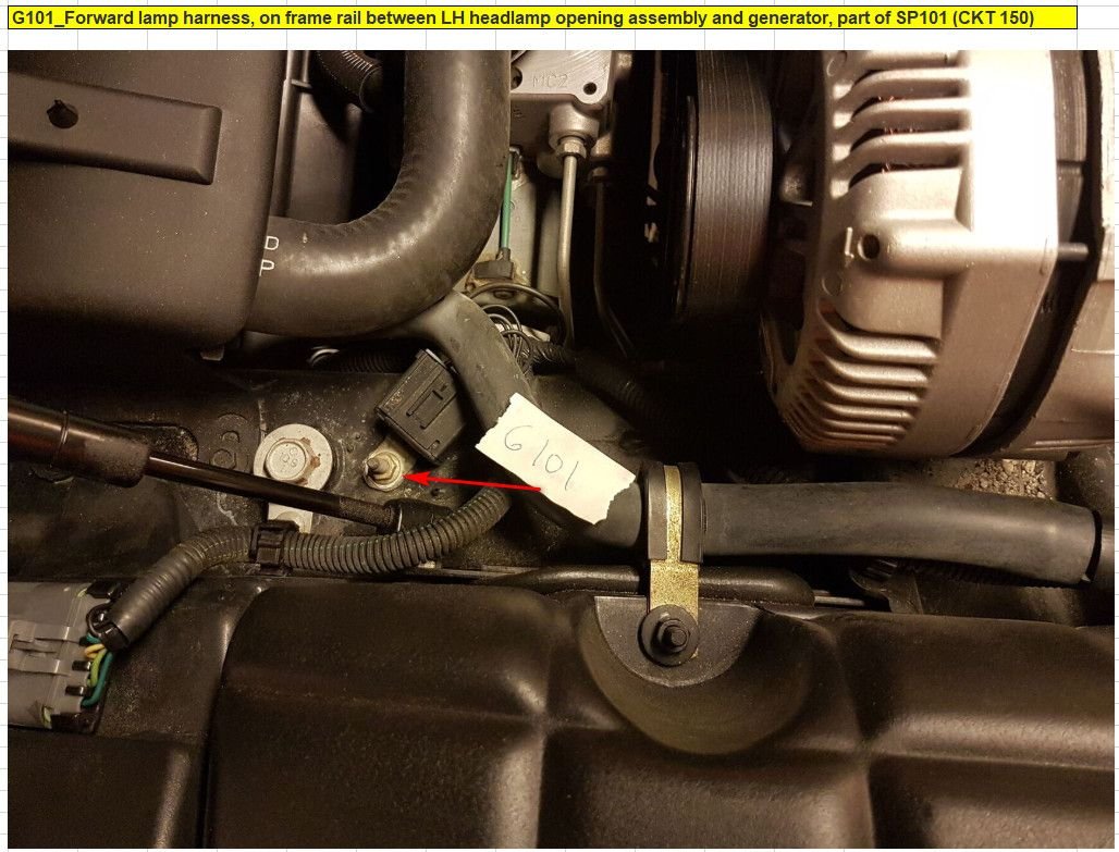

Here are info on some of the groundpoints and spliceconnectors in engine room.
As the first photo illustrate , it's good advice to inspect splicepoint connectors in additions to the ground point and inspect/ clean

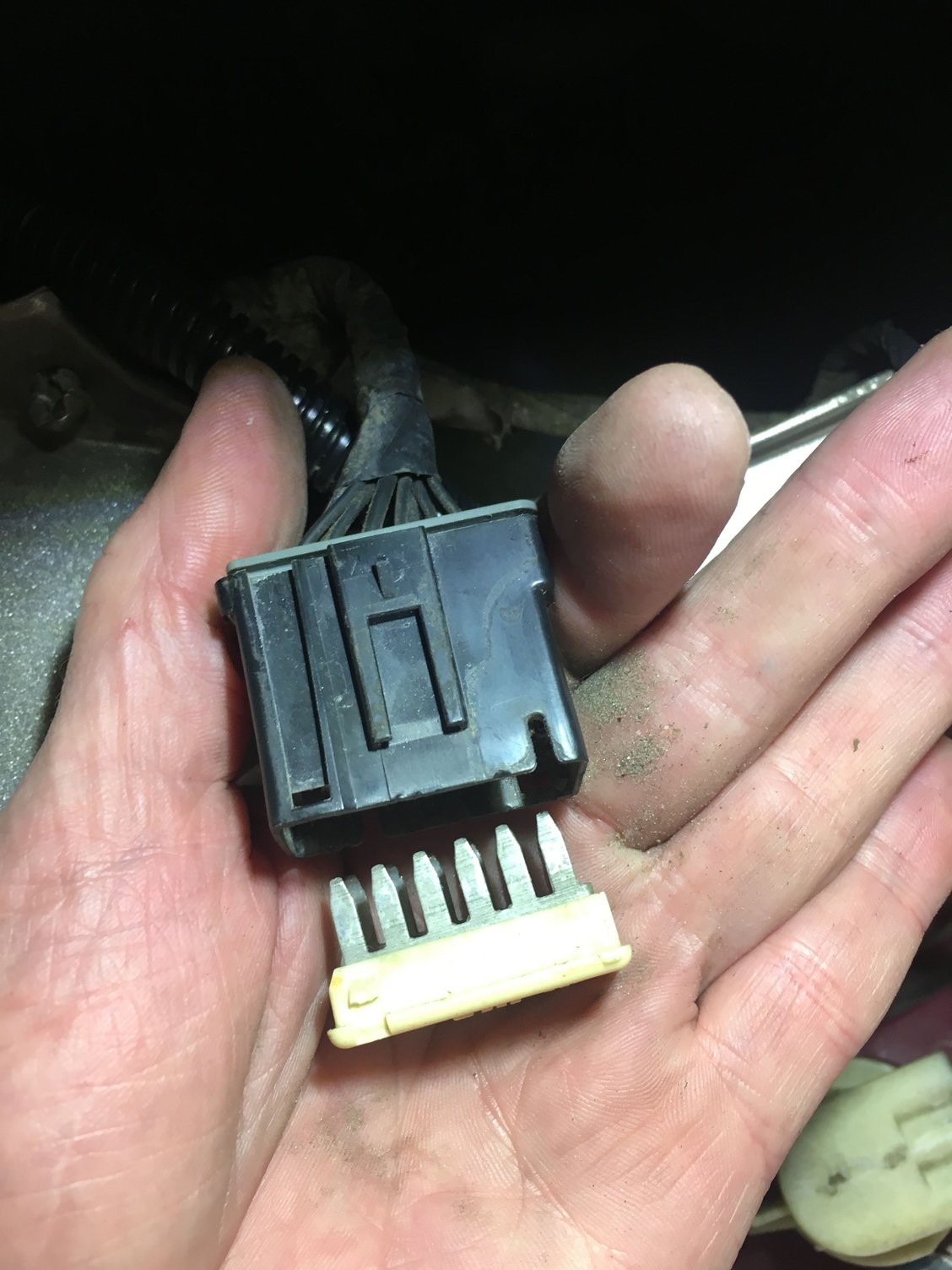

My passenger front splice pack. It was by far the worst one.
I found very small flat head screwdrivers best to hold tabs up to then withdraw pins. This splice pack was behind rear RH (inside of the two) tail lamp
The splice pack not shown above that I advise checking (because to the best of my knowledge it does have some relationship to the EBCM) was to be found on my ‘99 by removing the battery and battery tray. It’s a non bolted to chassis one.
The splice packs with cream/white caps are ones that don’t bolt to frame. Dark grey capped ones bolt to frame
