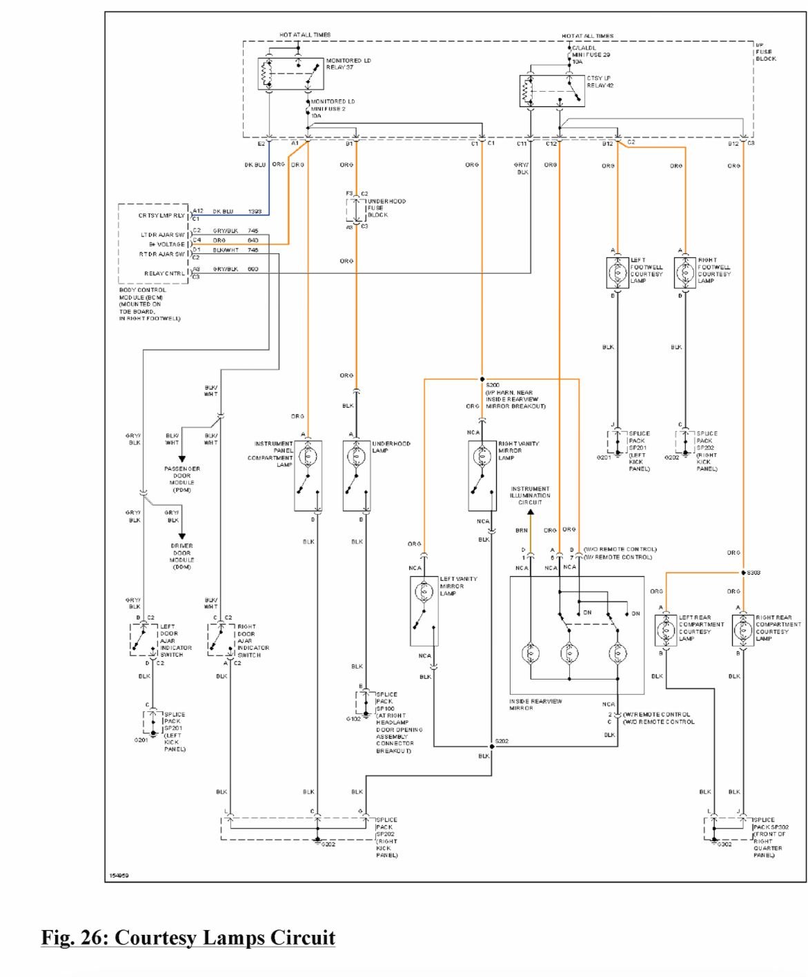

Maybe a bad relay, fuse, or door switch. Does it happen on both doors? Here’s a wiring diagram..

All other functions work when open the door doors (map lights, foot wells, door buttons, etc) except the instrument cluster lights.

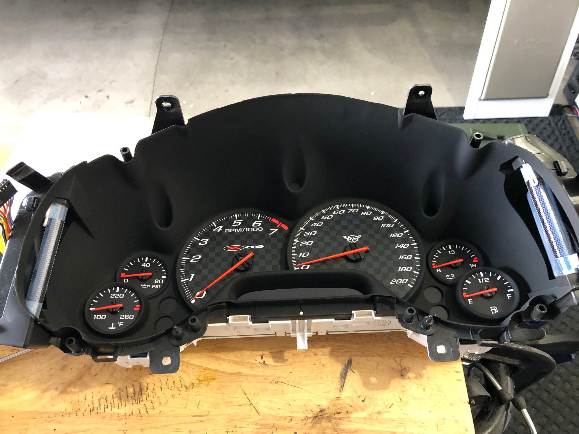

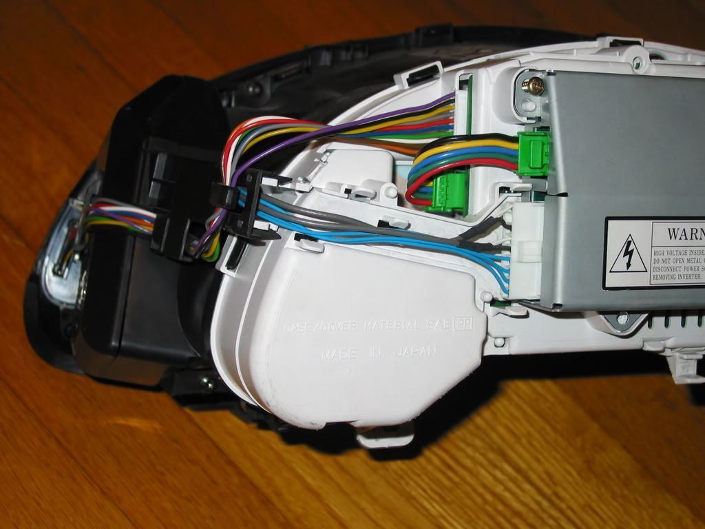

Yeah...the only things I think of that are left are fluorescent bulbs and the power supply in the IPC or wiring within in IPC. See pictures: 1 fluorescent bulb on each side and the power supply in on the back (silver box).
