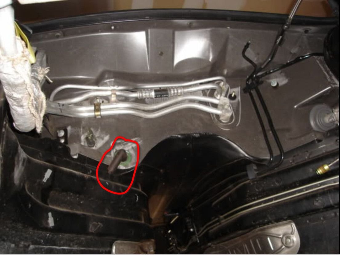

If you are seeing water in the passengers foot well and its NOT raining when using the AC, you have a plugged HVAC Drain. The HVAC Condensate must be able to exit the air box and drain on the ground. The HVAC Condensate drain is on the fire wall, passengers side directly behind the area where the back of the passengers engine head is. You should be able to reach it from under the car POP off the little 90 deg rubber fitting and see if water comes out of the air box drain. The end of the rubber fitting can get stuck shut or slime and dirt can plug the drain tube
