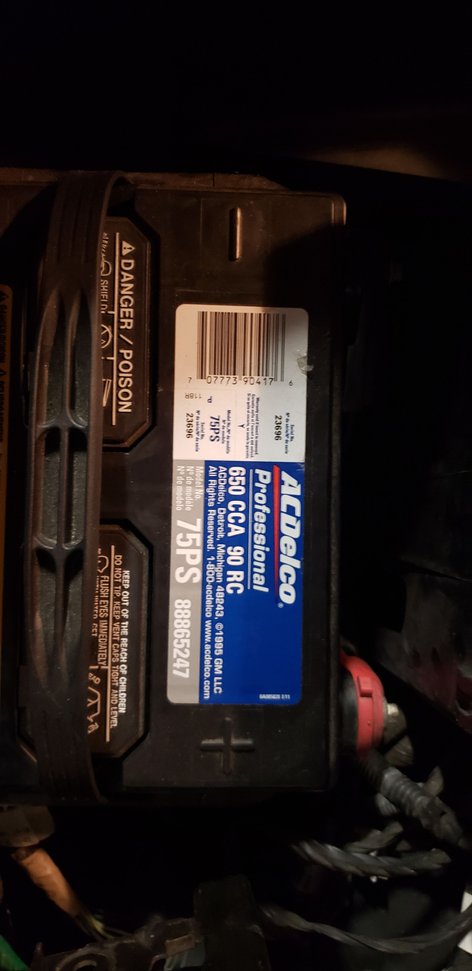

the battery that went bad was an AC Delco.. I wouldn’t buy that brand
Was it the “Professional” series ??...I probably could have got another year out of it but I’m usually pro active with these things !!
