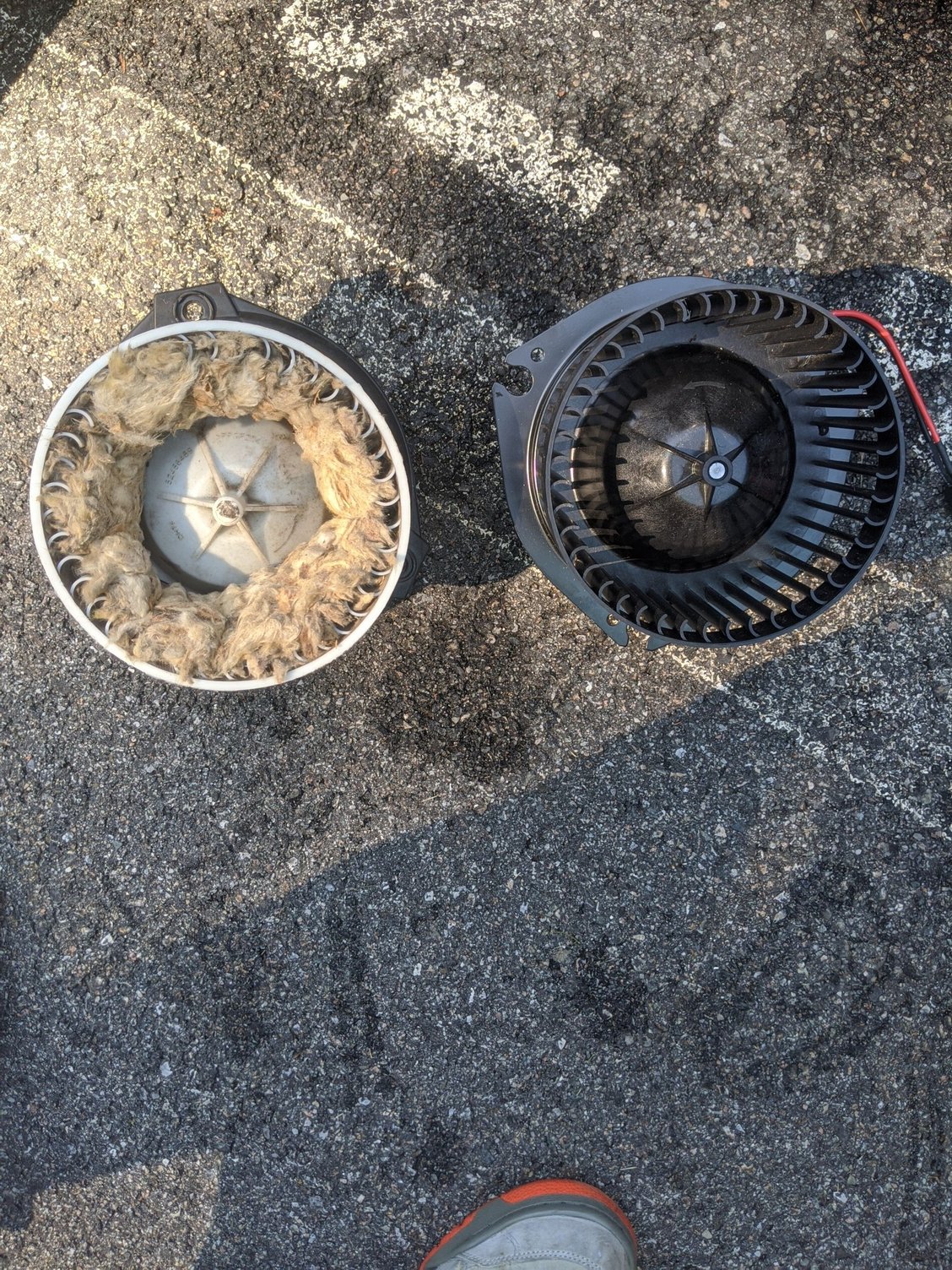

Originally Posted by slapshot12
I have a low mile (13.9k) C5Z, so it’s sat a lot during it’s life. There’s a musty, mildewy odor coming from the a/c. Is there anyway to get it cleaned out so the smell goes away or isn’t as bad?
i had the same problem...I also had low air flow coming from vents. I ddeiced to replace my hvac blower motor 25min job. When I removed the blower motor I found a rodent had been making a nest in there...it was full of fur leaves and nesting stuff.after I replaced it with the new fan no smell. Hope this helps. Old and new blower
See below
