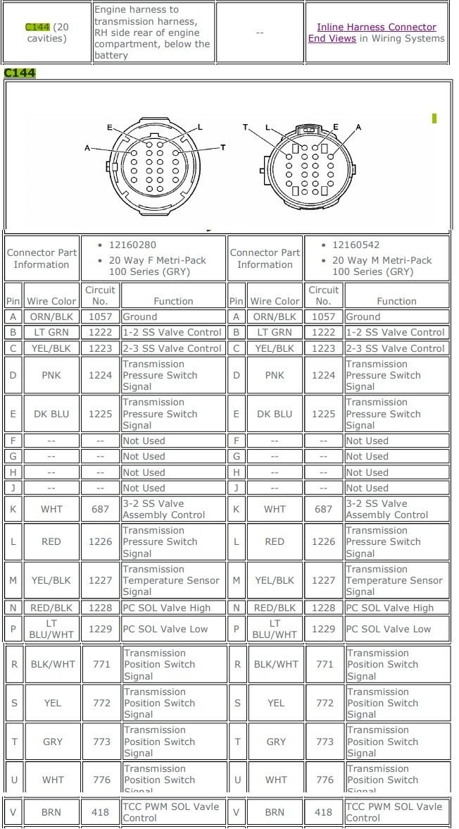

Circuit Description
The torque converter clutch pulse width modulation (TCC PWM) solenoid valve controls the fluid acting on the converter clutch valve. The converter clutch valve controls the TCC application and release. The solenoid attaches to the control valve body within the transmission. The solenoid receives ignition voltage through circuit 339. The powertrain control module (PCM) controls the solenoid by providing a ground path on circuit 418. Current flows through the solenoid coil according to the duty cycle (percentage of ON and OFF time). The TCC PWM solenoid valve provides a smooth engagement of the torque converter clutch by operating during a duty cycle percent of ON time. When the PCM detects a continuous open or short to ground in the TCC PWM solenoid valve circuit or the TCC PWM solenoid valve, then DTC P1860 sets.
Conditions for Running the DTC •
The system voltage is 8-18 volts. • The engine speed is greater than 300 RPM for 5 seconds. • The engine is not in fuel cutoff. • The PCM commands first gear.
After reviewing the system schematic two (2) connectors caught my attention..Connector C140 and Connector C144, (boxed in red on the below schematic).
Both Connector C140 and Connector C144 are located in the battery compartment zone...
Recommendation>
First, simple> Inspect the ENG IGN 1 fuse to see if it open or blown...Post up if this fuse is, in fact, open or blown...?
Next.
Remove the battery AND battery tray and locate and disconnect both Connector C140 and Connector C144 and inspect for corrosion on the pins, pay specific attention to the following pins;
Connector C140> Pin "E" Pink Wire.
Connector C144> Pin "V" Brown Wire
Post up your findings as this will dictate further trouble shooting steps.
