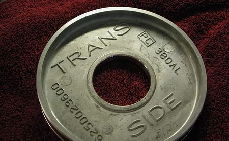

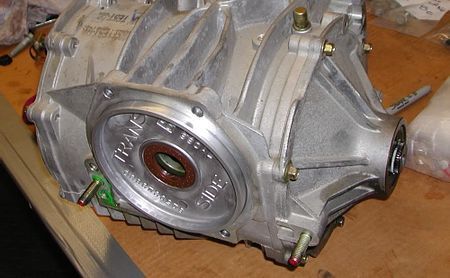

Check out my thread here. Lots of good info and links to build threads in it. I am going to tear down my diff before installing and check the Bellville washers so I am replacing some parts that if you just do a swap you won't need to do.
There is a 3.42 for sale here for $350 + shipping from California (expect $100 if close to Cali, $200 if not) but at $550 that is a good price. Most are $750 - $1500.
Parts that I have identified are:
Must have parts - all priced from RockAuto

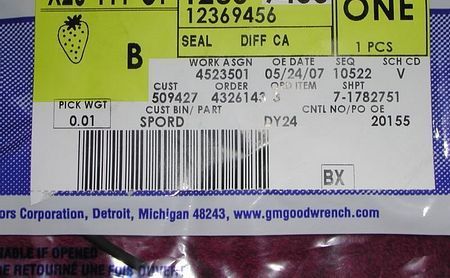

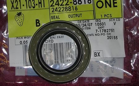

24228816 - differential seal x 1 $38.79 - This is the seal "bearing" that goes in the middle of the side plate that you will transfer from your 2.73 to the new 3.42
19259473 - axle shaft seal x 2 $17.72ea - These are the seals that go in the right and left covers where the axles go into the diff
12369456 - Main / Output Shaft seal x 1 $9.56 - This is the o-ring that goes around the side plate that you will transfer from your 2.73 to the new 3.42
89021677 - Diff oil with slip modifier added - 2 quarts or any brand of your choice
Tune for 25% reduction in partial throttle and WOT shift points (according to tblu92) $200 ~ $250 local to me
Parts if tearing down the diff before install
89047953 - Diff side cover seal x2 $22.79ea - These are the o-rings that go on the left and right side plates
89047954 - Diff rear cover seal x 1 $6.53 - This is the o-ring that goes on the rear cover.
19132817 - Diff Pinion Shim (also called the Bellville washer) x 2 $ 7.25 Note, not needed if doing complete clutch pack below as they come with it.
19132906 - Clutch pack kit x2 $102.79
12369457 - Side plate x1 $45'ish This is the side plate that you take from your 2.73 to put in the new 3.42 if you don't have one or you don't want to remove the one you have. It is discontinued but I found a few places that had it in stock.
Tune for 25% reduction is partial throttle and WOT shift points $200 ~ $250
If you are doing a teardown and you want further mods for higher horsepower then you may want to change the output shafts to the better Z06 shafts.
LH C6 Z06 output shaft: 89060119 $60.79 x 1
RH C6 Z06 output shaft: 89060120 $60.99 x 1
RH C6 Z06 Side gear: 19180962 $75.79
RH C6 Z06 Side gear retaining ring: 12458084 $5.07
I "think" this is everything. I will be doing my diff teardown 10/28 and the diff install 10/30. I'll report back in my thread what I found after each
