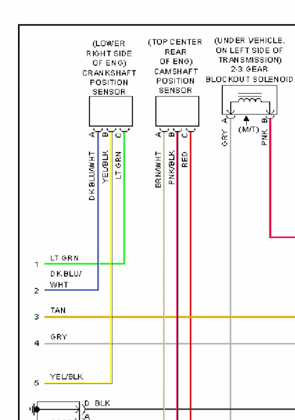

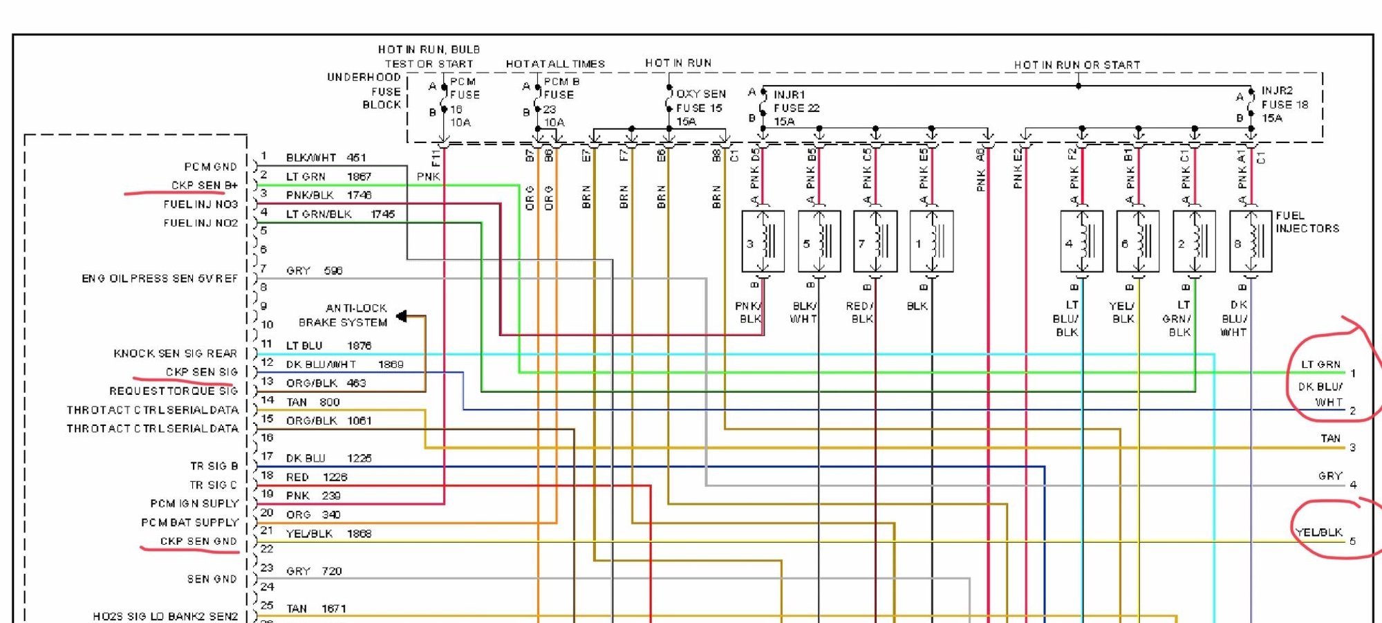

Refer to post #18. Again no RPM equals no crank position ref signal. Without that ref, the PCM doesn’t know what position the motor in, so no spark. You mentioned you saw bare wire...If the insulation on the wiring is worn/crack/missing you need to fix it. Use a multimeter to check the wiring...
