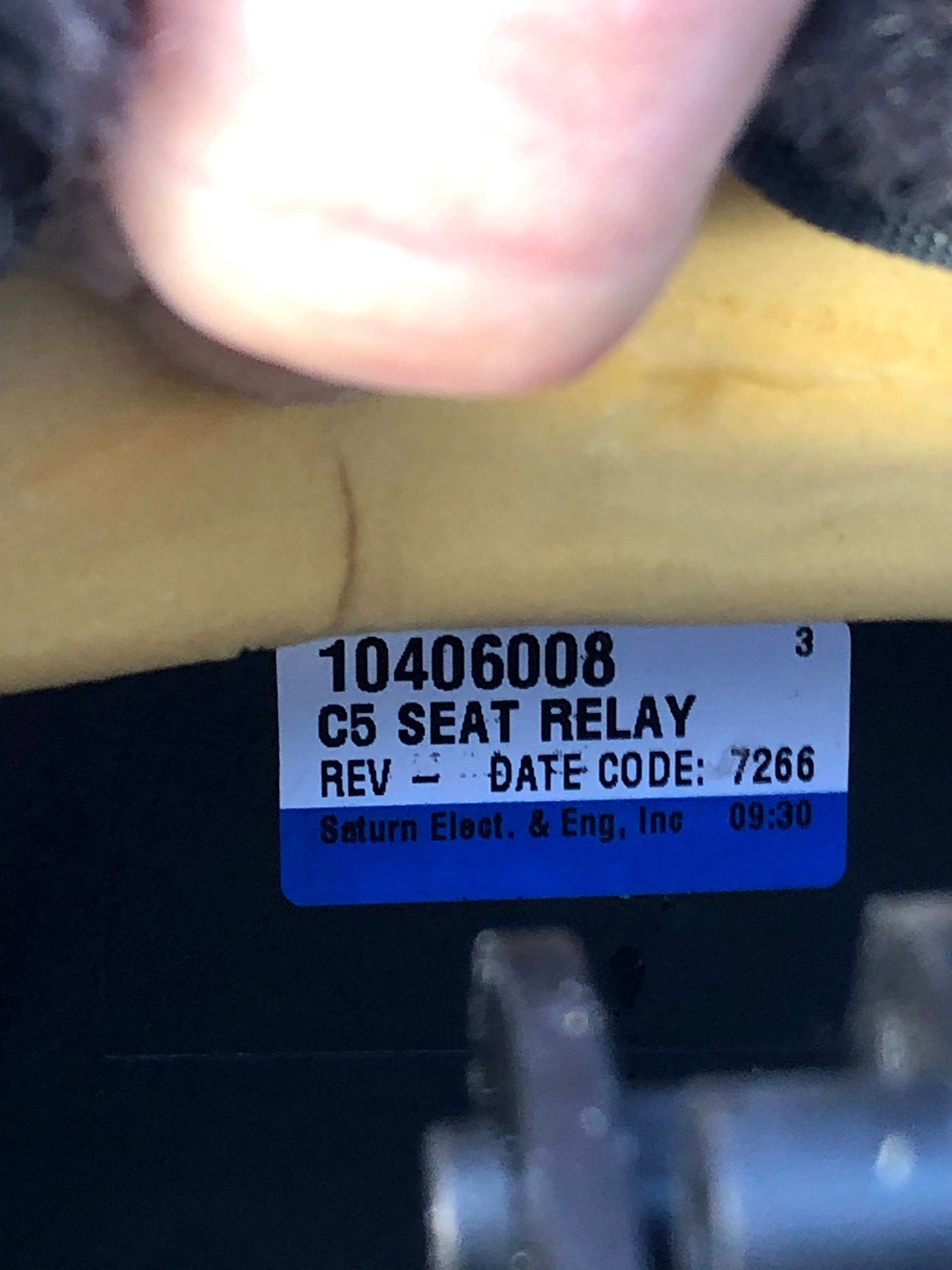

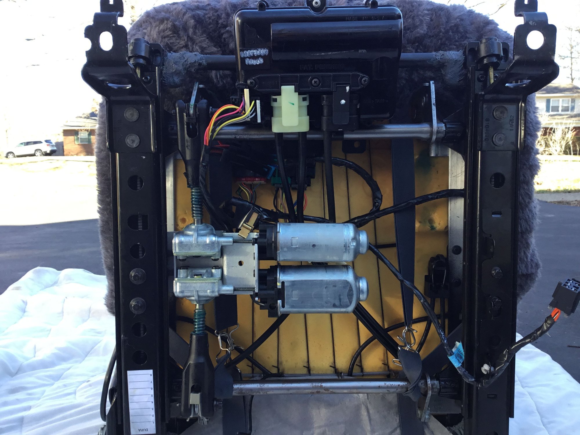

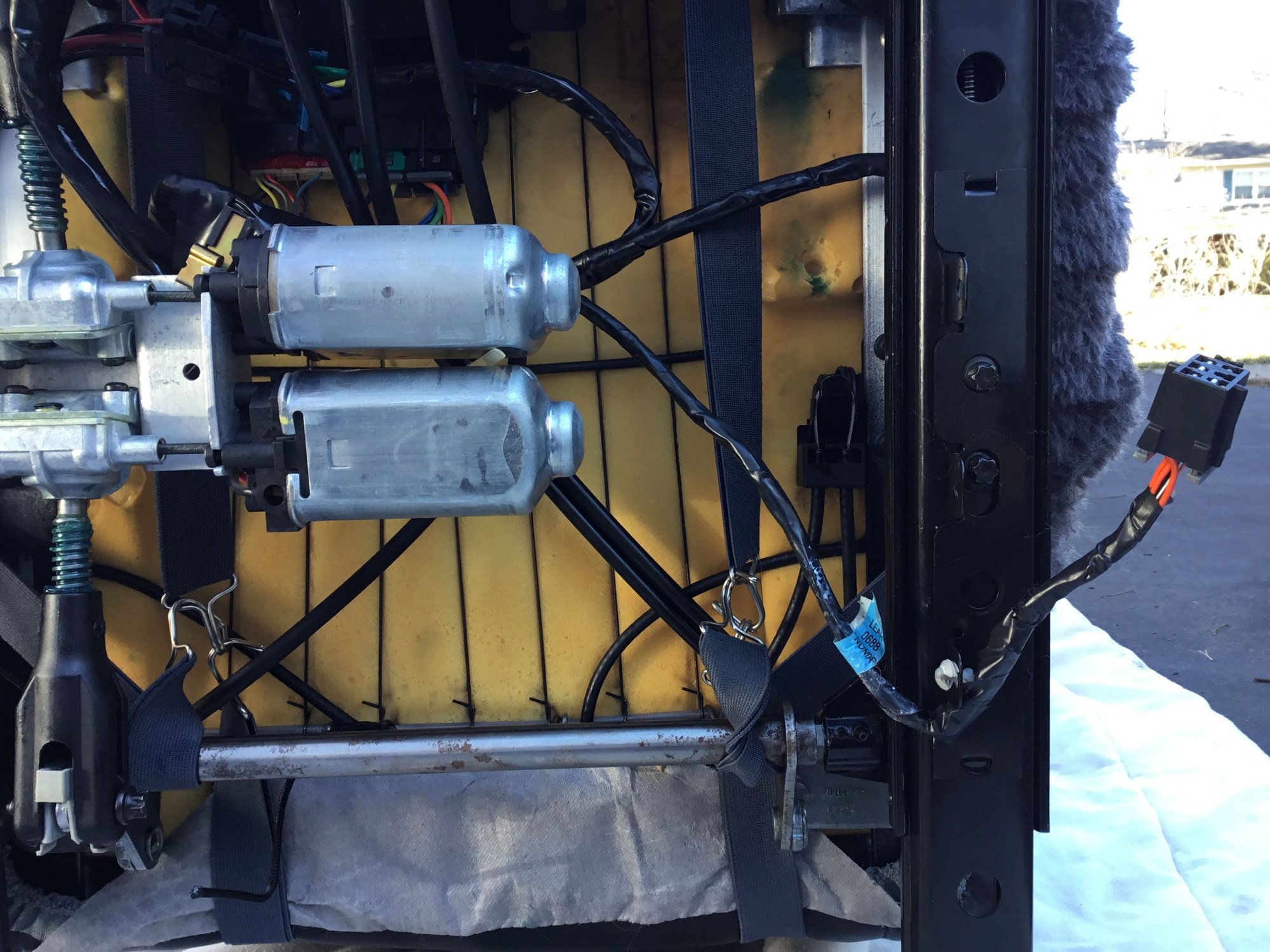

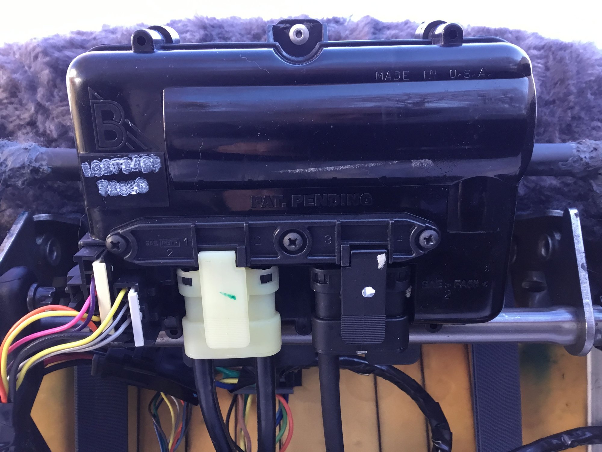

Ok,
Here are photos of the Sport drivers seat and the seat control module p/n from the Sport seat. Any advice will be great.
Ideal would be a wiring and seat track combination that gives my Sport drivers seat with full memory and the Sport bladders.
Great would be enabling the telescoping wheel with the Sport seat but no memory.
Thanks,
Mark

This is going to take a bit to get working right.
The sport seat you have is from a 97 which uses a different lumbar/bolster pump assembly than other years. I have the correct seat harness for a 97 sport seat with memory but without telescopic column.
OPTION 1: You will need to swap the tracks between the drivers seats to make the memory stuff work as well as the lumbar pump and seat control module. The pump is the black box attached to the front of the seat track. To swap the tracks the bottom seat cover has to come off to unbolt the track from the seat frame. The memory seats have a 2nd connector on each of the motors for the position sensor. This will not give you a functioning telescopic column. You will need the harness I have to make this work.
OPTION 2: Swap the seat skins and foam between the seats. This will give you all the memory functions working and the telescopic function. It will not give you the lumbar/bolster functions. The seat frames are the same for both the standard and sport seats.
Let me know which way you want to go with this.
Gary
