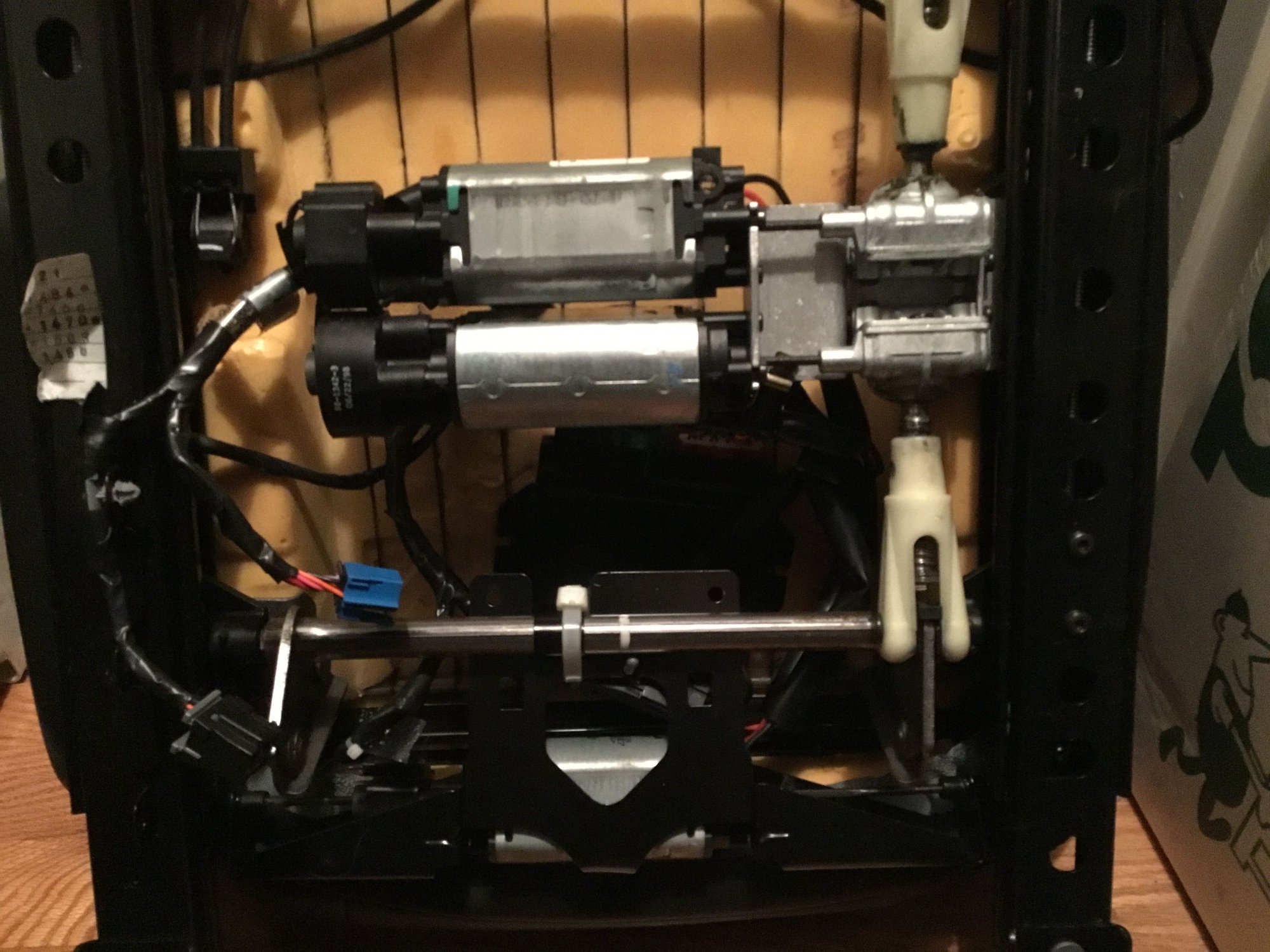

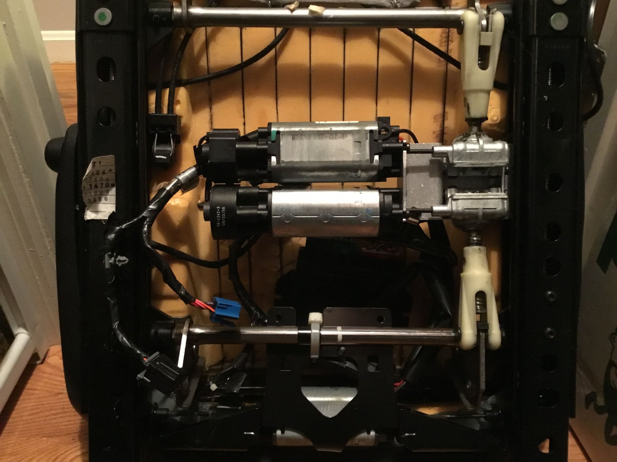

Here are my stock two connector memory drivers seat and my Sport no memory with bladders single connector drivers seat.
Thanks for any advice!

Looks like your replacement seats are from a 1997. I looked through the spare parts I have and don't have the correct seat harness you would need to keep everything functional. Every harness I have is for a 1998-2004 seat. And none of the ones I have have the connector for the telescopic column. The 1997 sport seats are different than the other years. They have a different pump module for the bladders.
Let me think on this a bit for a solution.
Gary

Just noticed in the pictures that the new sport seat pictures were of the passenger seat, not the driver.
Also, can you remove the seat control module from the drivers sport seat, need a picture of the part number label to verify option.
Gary
