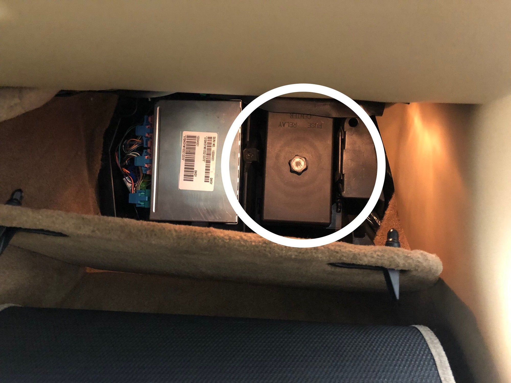

Additional dumb question.....how do I access the fuse panel in the passenger footwell?

Do these DTC’s have an “H” or “C” after them ??... these are either history or current codes..these are U codes which are communication codes...if the car is running OK right now I’d clear them and just worry about the AC...does the AC clutch engage when the AC is turned on ??...this issue can be a couple of things..,the fuse panel is behind the panel with 2 latches where your passenger would put their feet...open the latches and remove the panel...fuse panel is circled in picture..remove the center screw and take off the fuse panel cover !!

Thanks for the visual for the panel. A great help! Thank you!
