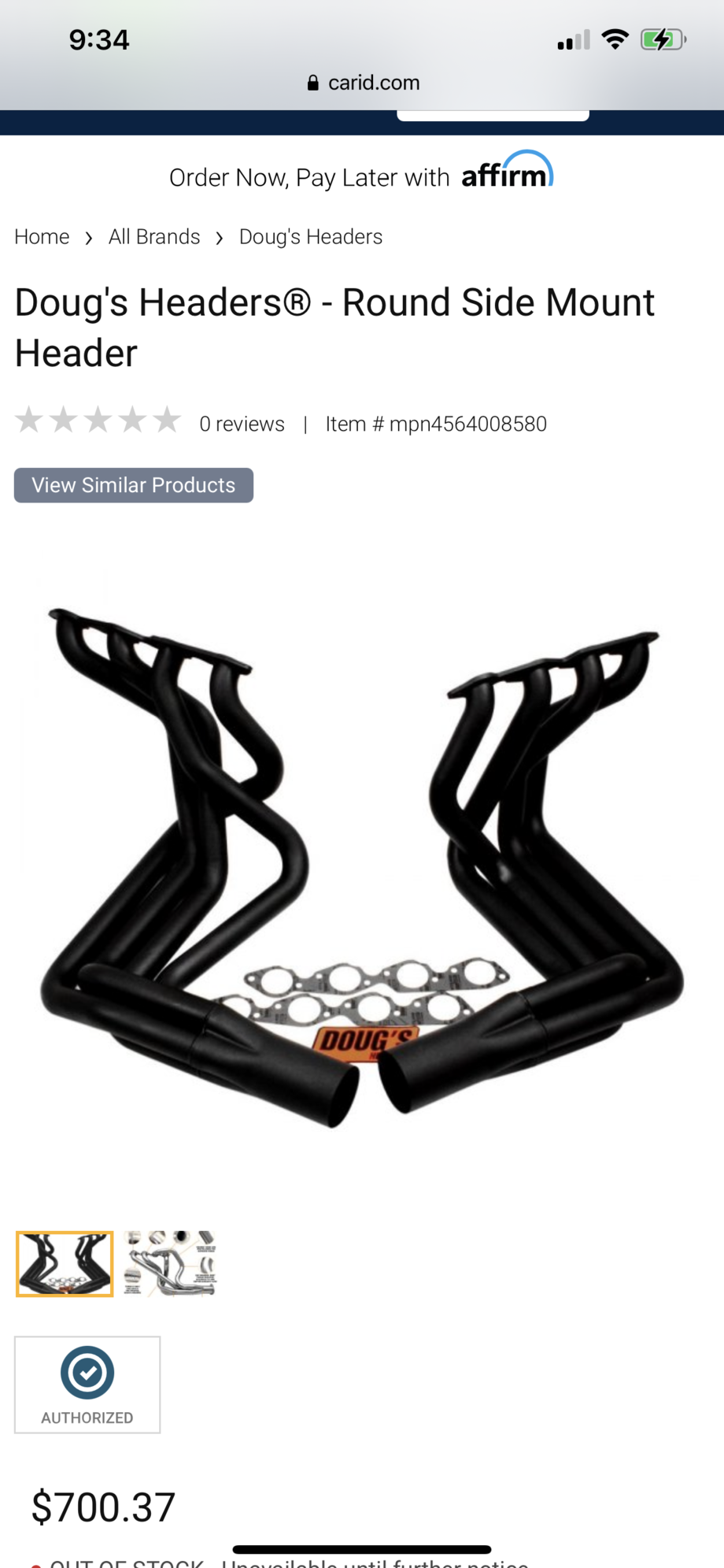

Your gonna need the header the splits from one to 4 pipes outlets on each side of the car kind like the drag car or pro street ones

Now THAT I would be all about !
If u look around u will find them but it’s not gonna be stuff u can find at summit and are gonna be a bit more costly...and u can match whatever length U want. I’d say going 10 inches out the side roughly is what u will need to prevent burning the panels ....and ur motor will run top notch with those style of headers...
Throw on a welded outlet with 4 equal length pipes and u got it made

If there was a way to reasonably package side exit exhaust I would do it.
Once you cross the $40k number on a C5 build nothing is off the table.
Ya I’ve crossed that hump a while back lol , but I don’t see why a 1 7/8 side mount heat wrapped with a custom end wouldn’t work ..total prob a 2-3k set up all said and done
