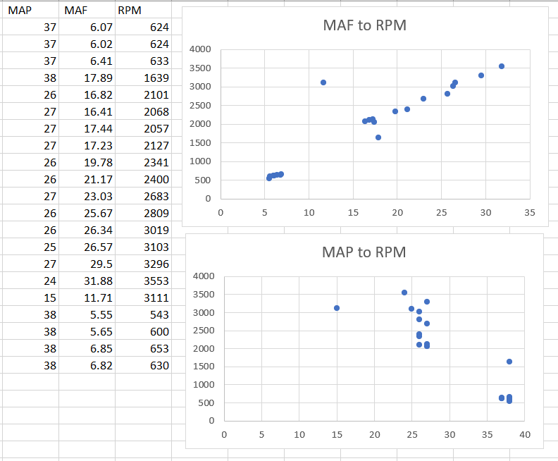

I have been trying to log the MAF and MAP and RPM all day. I have graph form and data form on the device but no way to transfer it to the computer and I've been trying to figure that out for about an hour. I don't really want to type out 600 numbers from the device to my pc so I only did every 12 of the 240 and here are the graphs I got (20 total data points)
The outlier on the MAF is on immediate deceleration. You can see in the data char to the left, the top value is time = 0 and bottom value is time = 20 and I did stair stepping idle up to 4000 about every 500 rpm increments and then let off the gas at the end back to idle and that generated the outlier.

Great job graphing work!. It looks like you had a very good result before cleaning. Don’t worry about the deceleration graph; the second one. The top graph, ignore the outlying data points. That is probably a sampling interval issue and perfectly normal foe there to be an instantaneous spurious datum. The MAFvsRPM looks very linear GOOD. So, if the conditions after cleaning did not change, then MAF may be ruled out. C5 Diag is spot on regarding vacuum leaks, so let’s see if you caused one during disassembly. I like to put silicone grease, a very light coating on the inside of the bellows between MAF and TB in the area that seats on metal. A quick check for vacuum leaks is to spray a SMALL amount of brake cleaner or your TB/MAF cleaner at suspected vacuum leak locations. Best done on a cold engine. If the engine immediately speeds up, you have found the vacuum leak. The cleaner is a fuel and so you are adding fuel and air (the leak). The engine should briefly increase RPM until it sucks in all the cleaner.
I noted in a previous post several vacuum leak sources. Cyl 3 might be an intake gasket. Wouldn’t be any harm checking torque on the intake plenum bolts, especially around #3 BTW, 1357 cyls are driver side (bank 1) 2,4,6,8 passenger side (bank 2)

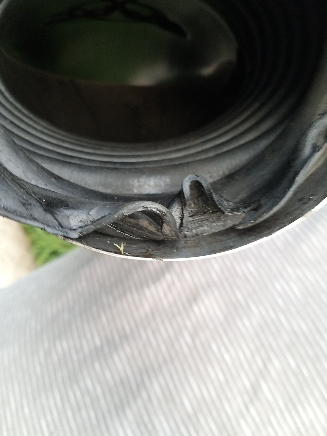

Well funny you say the area between the maf and tb because it has looked like this since i purchased it:
So this spot is the top side that clamps onto the metal throttle body. I don't know what happened, but the previous owner didn't take good care of the car. What's this part called? I'll try to order a new one.

Air bridge GM 25314823
To Misfire (P0300)

The poster above has the name. You probably won’t find a new one. Lots of them around, as many have replaced the intake/air cleaner with “cold air” intakes. Waste of money.
You will have to go to a Corvette salvage to get one. You need the 01-04 version, not the 97-00 version. Marc Rose at Vettenuts is a forum vendor. His business is in Bedford County TN . Then VettePros in Charlotte NC 704-320-0073. You may find an air bridge in the C5 parts for sale section too.
That is a good find on your part. That connection has to be air tight. That is a source of un-metered air. and for sure a source of varying change. The engine will rock a bit when you wind it up and this will open for more air. Fixing this will calm the engine variations so trouble shooting can finish. This would be a very frustrating condition. No wonder you are having a fit with this!
