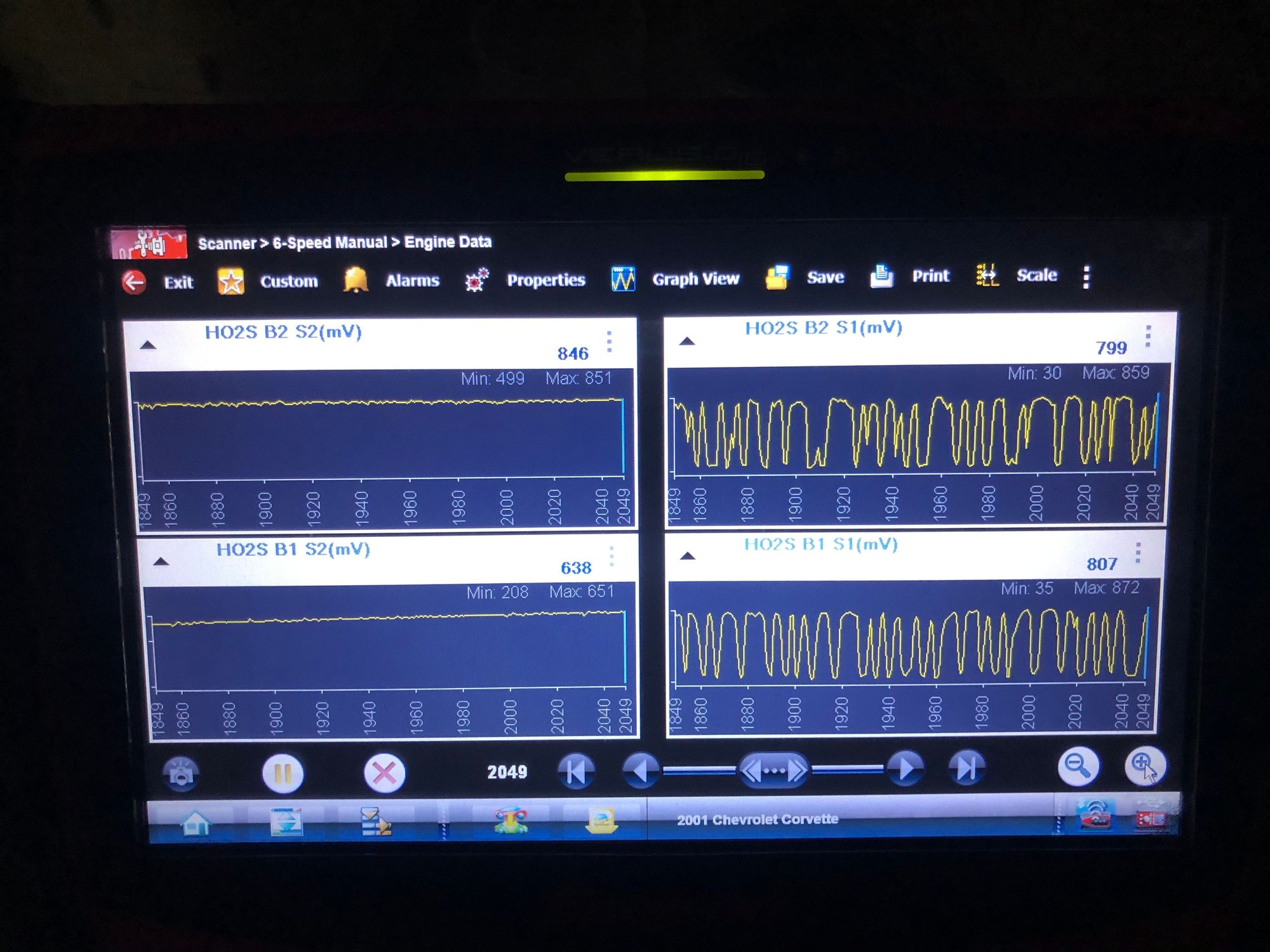

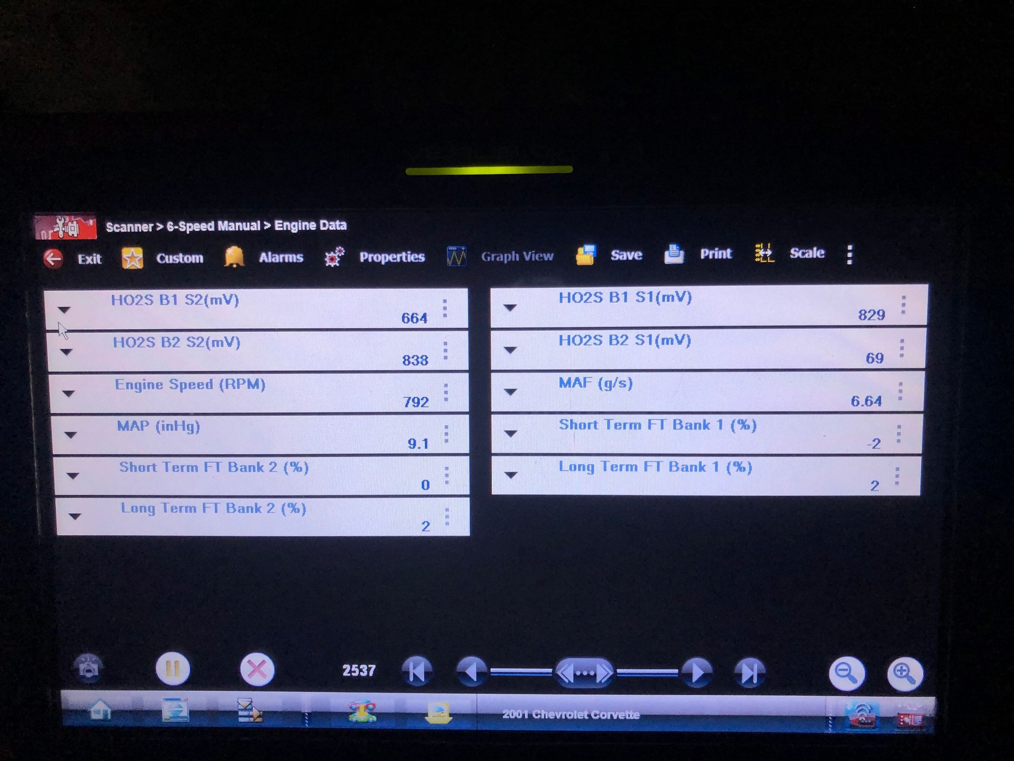

The MAF also seems to read fine. It goes between 6.0 and 7.0 g/s while at idle.
Sometimes my heated oxygen sensor 1 drops down to 50 mV but the #2 sensor stays consistent between 700 and 800mV

Your MAF is reading fine...at idle it should read approximately your liter displacement in grams/second...what are your long and short term trims on both banks at idle and 3000 RPM ??...below is a screen capture of my upstream and downstream O2 sensors at idle and some other data PIDS...the downstream (sensor 2) should be steady at about 700-800 mv’s...upstream should oscillate between 200-800 mv’s !!...if upstream go lean (below 450mv you should see your fuel trims go positive
Old May 23, 2021 | 08:10 PM

Okay here I recorded a video of all that data. I'm not quite sure what to make of it.
It seems fine based on what you said I think. So this wouldn't point to an issue I don't think?
EDIT:
I watched a video about fuel trim.
Does my long term fuel trim seem a little high? especially at 3000 rpm? That would mean it might be a little lean?
Also your O2 sensor 2 on B1 and B2 are giving high volt but mine give low volts at idle.
