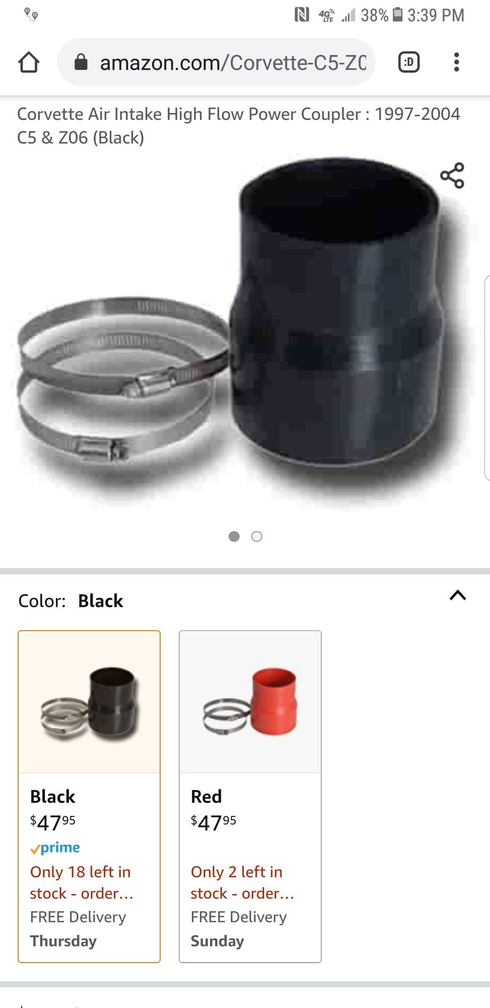

I purchased this on amazon and will have it thursday:

Not sure about the big A part. may work ok. Personally, I would buy a good used OEM part to make sure another variable is not introduced.The Oetiker clamp that holds the bellows to the plastic bridge is narrower than a worm gear hose clamp as pictured.After install if it still is crazy, use the brake clean spray method on the connection points.

Sad to report that the new air connector did not fix the misfire issue. I think it might have been sucking in more air through the MAF instead of the leak now, however, because the MAF reading did seem slightly higher than before which is good, but I didn't get to do a lot of testing today at temp. I can't work on the car for the next week so I will resume investigation after then.
