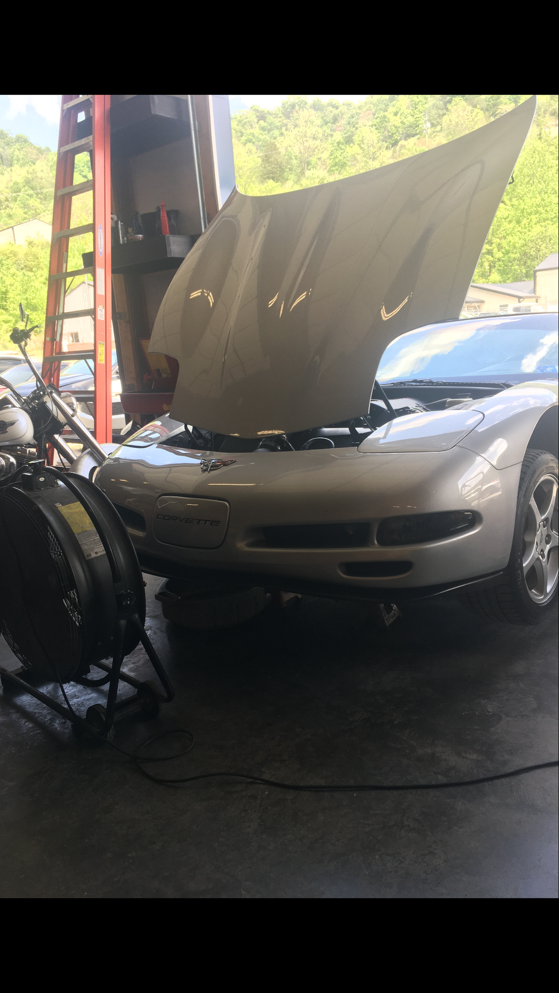

I have a 2003 base corvette.
mall lf a sudden it started running around 240.
So I took and replaced the thermostat with a 160 rather than the stock 195. I also blew out the Raditor and condenser coil and change the antifreeze.
my issue is. While sitting still I range between 195-205. When it hits 205 fan comes on and brings it back to 195. But while driving not hard just anytime giving it gas or going up a hill the temp will go up to 250. I have never seen a car that got hotter while driving any ideals

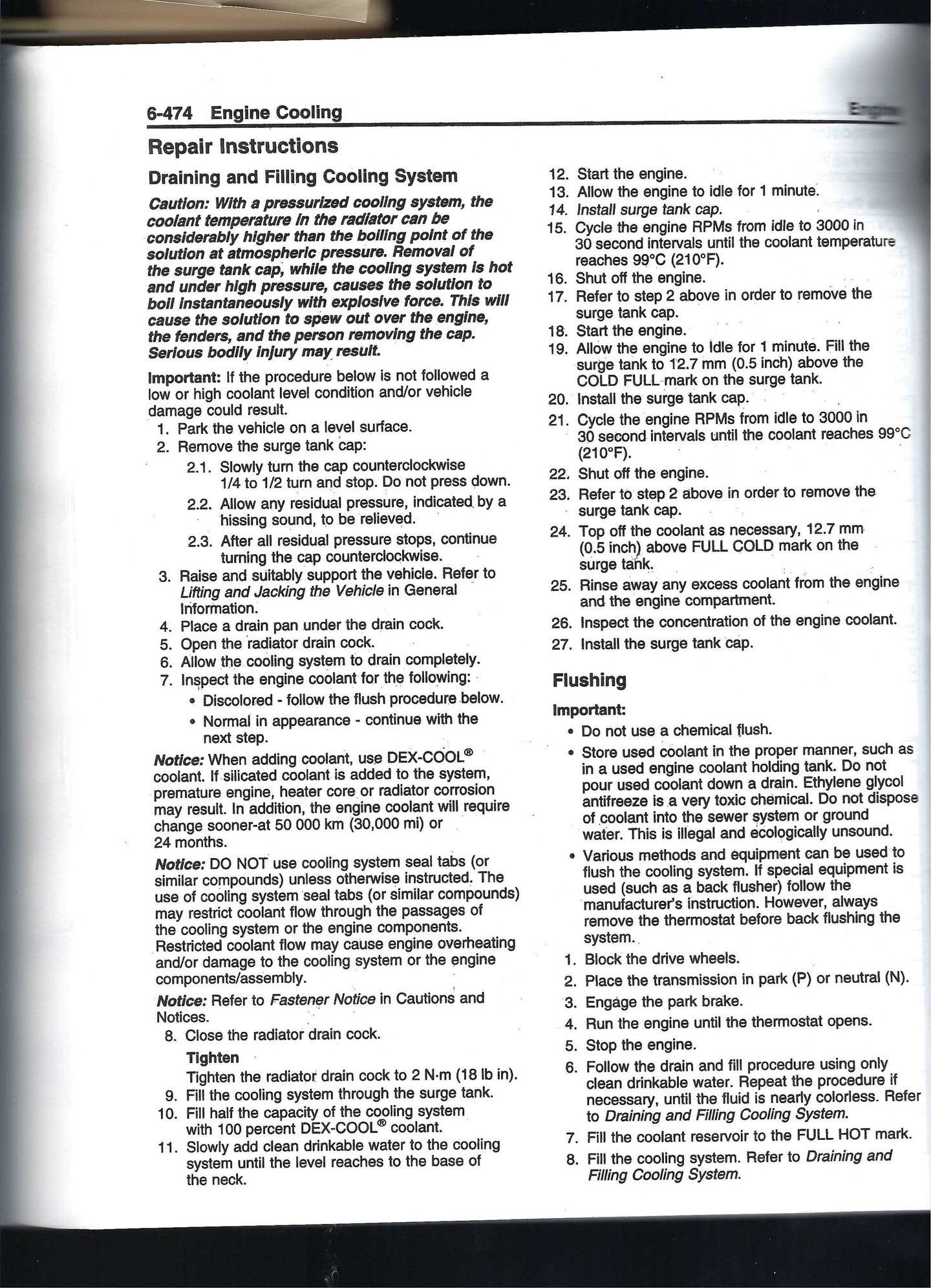

Browse the forum on how to remove the air from the cooling system. It takes a few tries to get it right. Might solve your problem. Also, are the front air dams still in place?

Sounds like you have some air trapped in the system still

250 while driving above 35 mph is too hot. As others have suggested it is possible that there is still air trapped in the heads. That could have happened when you changed thermostats. There is a specific procedure in the Factory Service Manual for purging air from the heads after changing coolant or dismantling the cooling system in any way because opening the cooling system is likely to cause air to get trapped in the heads. Try this first.

Does anyone this the chin spoiler would affect the air flow. Could this be a cause. It was recently put on

Yep a spoiler can cause high temperatures at speed.

Issue solved. Front spoiler was cause the air to be re directed and not cooling the radiator while driving.
Simple fix
